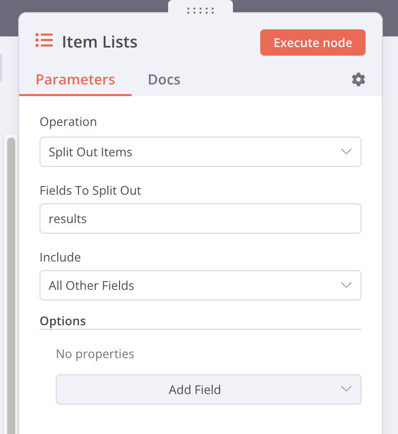

Hello,
I am wondering what’s wrong.
In the cloud version of N8N, I’m having issues splitting this list as items.

Hey @Joachim_Brindeau. The issue is on the input data that you are passing to the list node.
You are trying to pass {{$json.results}} which isn’t valid (double-check the output of the HTTP node, and you will see why).
Basically, you are passing an array of objects that is inside another array:
[[{“siren”: null},{“siren”: “000000000”},{“siren”: “000154652”},{“siren”: “005720784”},{“siren”: “006380042”},{“siren”: “006780514”},{“siren”: “007080773”},{“siren”: “015551278”},{“siren”: “016250029”},{“siren”: “016650996”},{“siren”: “016950545”},{“siren”: “016980062”},{“siren”: “017050410”},{“siren”: “017251067”},{“siren”: “025680471”},{“siren”: “025750084”},{“siren”: “025980186”},{“siren”: “026320028”},{“siren”: “026550095”},{“siren”: “027320134”}… etc]]
But you should pass the container array.
So your input should be “results”:
Sorry about that! I found that out a few minutes before you posted and it works. :slight_smile:
Thank you very much for taking the time to write this answer!
