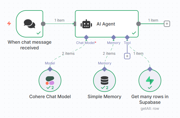

Thanks for respondong, @jabbson. here is my workflow.
As an additional information, I already tried 3 AI model, Gemini, Open AI, Cohere, all not resolved the issue.
I hope to find the solution for this issue.
Nope, still a screenshot.
Sorry, I have posted my workflow on prev post. Thanks for your help @jabbson.

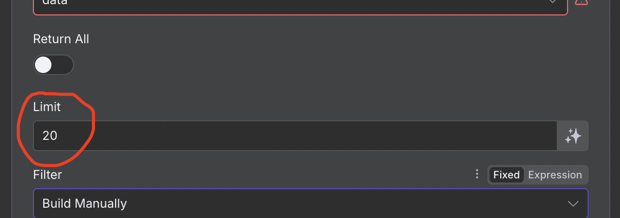

I appears that your tool is limited to catching only 20 results.
and no filters are applied, which means that the tool will attempt to get 20 results and return it to the agent which will perform transformations or calculations requested by the user.
I tried to change the limit to 20,000 (same as total records), and the process become very lagg.
