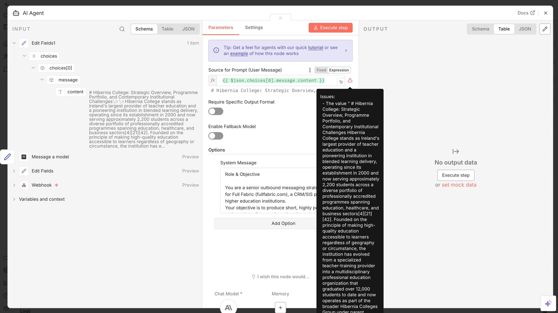

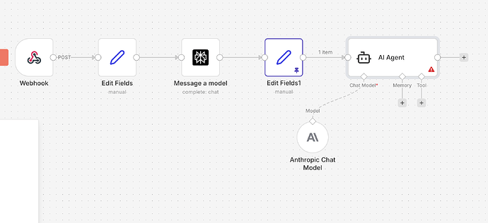

I’m in the AI Agent node. The Chat Model is properly configured and connected, so that’s not the issue.
I drag and drop message.content into the User Prompt field (or use the equivalent JavaScript expression), and immediately I get a validation error. The error message is too long to read in the UI, so I can’t even see what it says.
I have no idea what’s causing it. I’ve tried multiple fixes suggested by ChatGPT, but nothing has worked so far. And I cannot SEE the bug/error so I’m having to debug blind… as per the screenshots

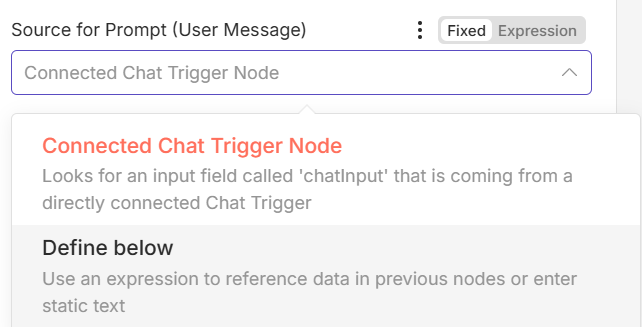

hello @rubk
The field Source for Prompt is a dropdown field that supports only two options:
It doesn’t support custom text. You have to select the “Define Below” option and then add your text to the prompt field
Amazing thanks a lot @barn4k you rock!!
