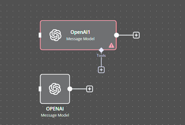

I’m experiencing a problem with my local installation of n8n (version 1.81.4) when creating an OpenAI agent using the “Message a Model” node—the only node I’ve found that returns output in JSON format. When I select an LLM from the OpenAI list, the node properly connects to the tools. However, if I use a dynamic LLM expression, the agent node loses its connection with the tools, preventing me from using any of them. I also tried the standard Agent Tools node, but it doesn’t allow “output to JSON.”

Thank you for your suggestion. I understand that the Tools Agent node offers a structured output by enabling the “Require Specific Output Format” option and connecting an appropriate output parser.
However, my requirement is for an automatic output, similar to what the “Message a Model” node provides, because the LLM’s responses vary each time. The preformatted structure from the Tools Agent doesn’t accommodate the dynamic nature of the LLM’s outputs in my use case.
Additionally, I prefer not to add an extra LLM-based output parser to fix the response, as it increases both workflow execution time and computational costs.
