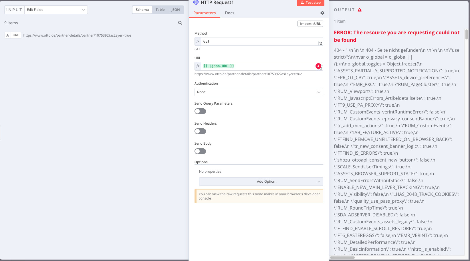

Hello n8n Community,

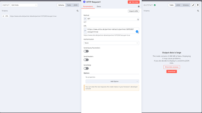

I’ve been encountering an issue with the HTTP Request node where it seems to treat my dynamic URLs differently than when I input the URL directly. The dynamic URLs result in an error, while the exact same URLs inputted manually lead to valid results.

Here’s what I’m trying to do: I have a workflow that extracts several URLs using JavaScript code and stores them in an array called URLS. I’m splitting the array out into single strings. I then want to use these URLs in an HTTP Request node to fetch data from the URLS.
When I use a static URL (in this specific example, "https://www.otto.de/partner-details/partner/1075392?asLayer=true") directly in the HTTP Request node, it works fine and I get the expected response. However, when I try to use a dynamic URL (in this case, {{ $json.URL}}) that contains the exact same URL, I get an error response from the API.
The error message is:
Item Index: 8
HTTP Code: 404

Here are the steps I’ve taken:
  1. Extracted the URLs and confirmed they are correctly stored in the matches array.
  2. Used the HTTP Request node with a static URL – which works without any issues.
  3. Replaced the static URL with the dynamic variable from my matches array, which results in an error.
  4. Used a Set-Node before the HTTP Request, as suggested in this post
I’m including screenshots of my workflow configuration, especially the HTTP Request node setup and the error I receive.
Thank you in advance for any guidance or assistance you can provide!
