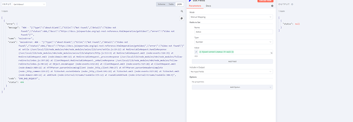

I’m facing trouble with dealing with the ‘error’ output generated by a HTTP node, whether it’s via the Include Response Headers and Status == true approach, or with the On Error == Continue (using error output).
The issue is, the data in the ‘error’ object is not being correctly parsed/considered by the nodes following the HTTP node (Set node/IF node). [See screenshots below]

Something strange with this scenario is, that after executing the workflow (and not destroying the data), if i re-run the Set nodes, the correct value populates in the node output:
Hey @shrey-42,
Thanks for the example I will get a bug ticket created shortly for this.
Quick Edit: Internal ticket for this is NODE-1048
