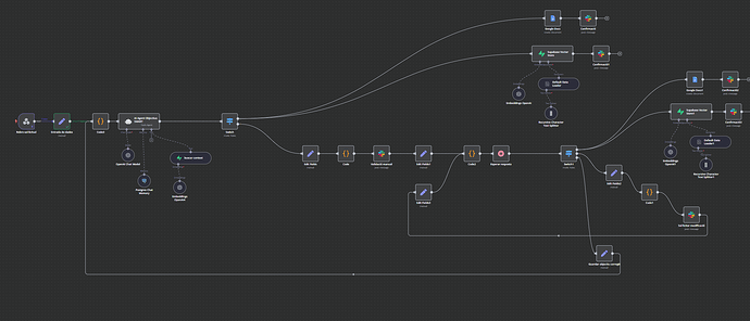

Hi! I’m building a workflow where an AI Agent processes input data and returns a response. The user can then validate or modify the response via Slack. If modified, the flow enters a loop and sends the new input back to the agent.
:red_circle: Problem:

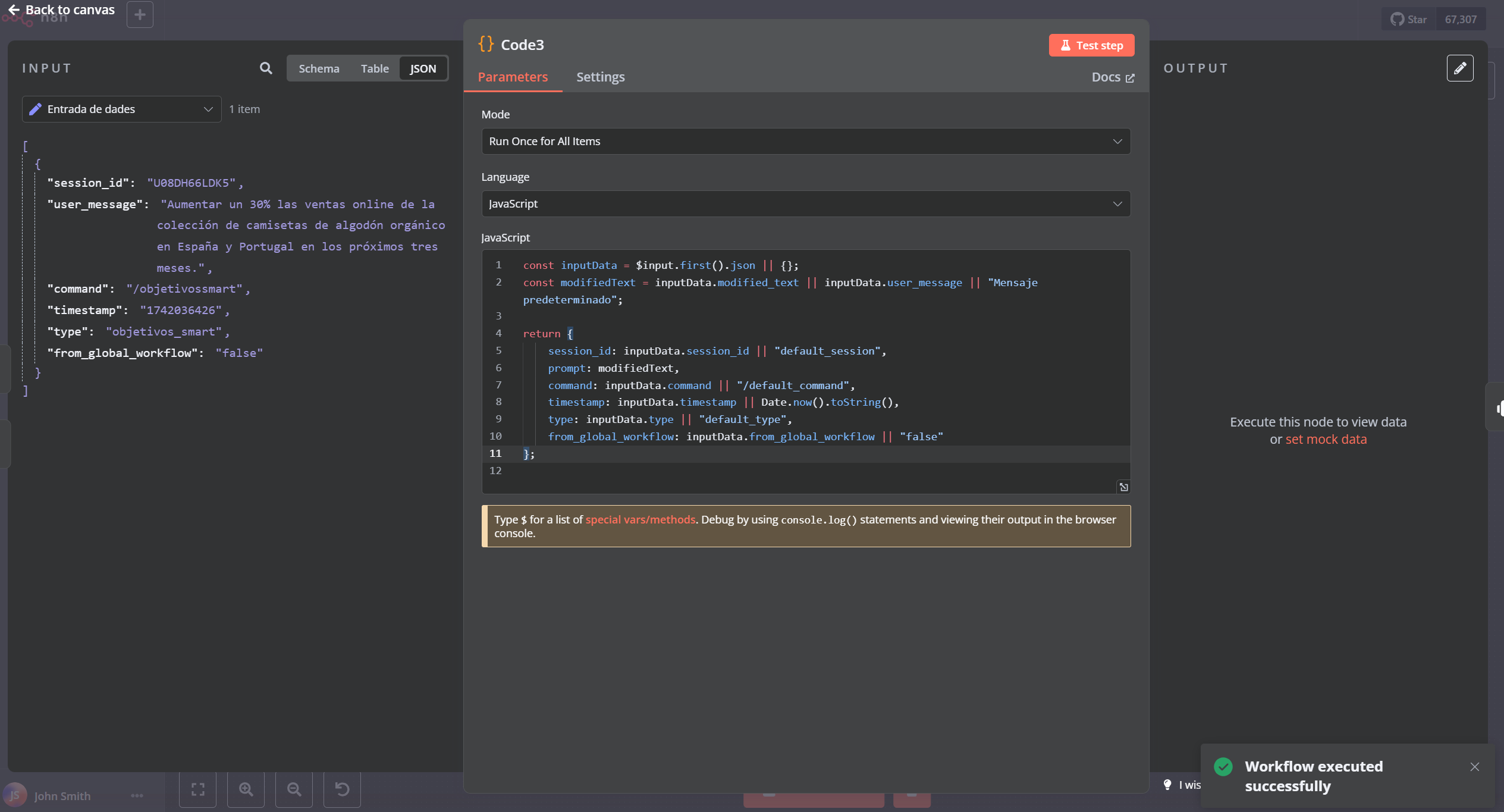

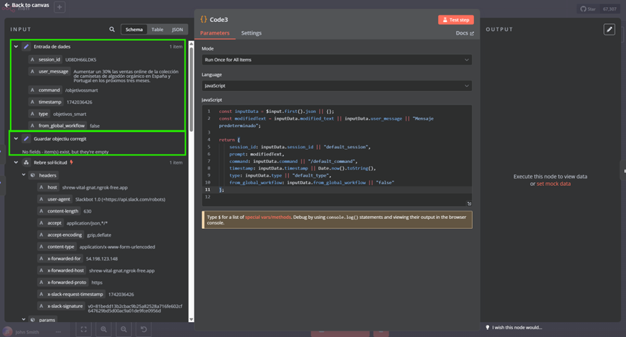

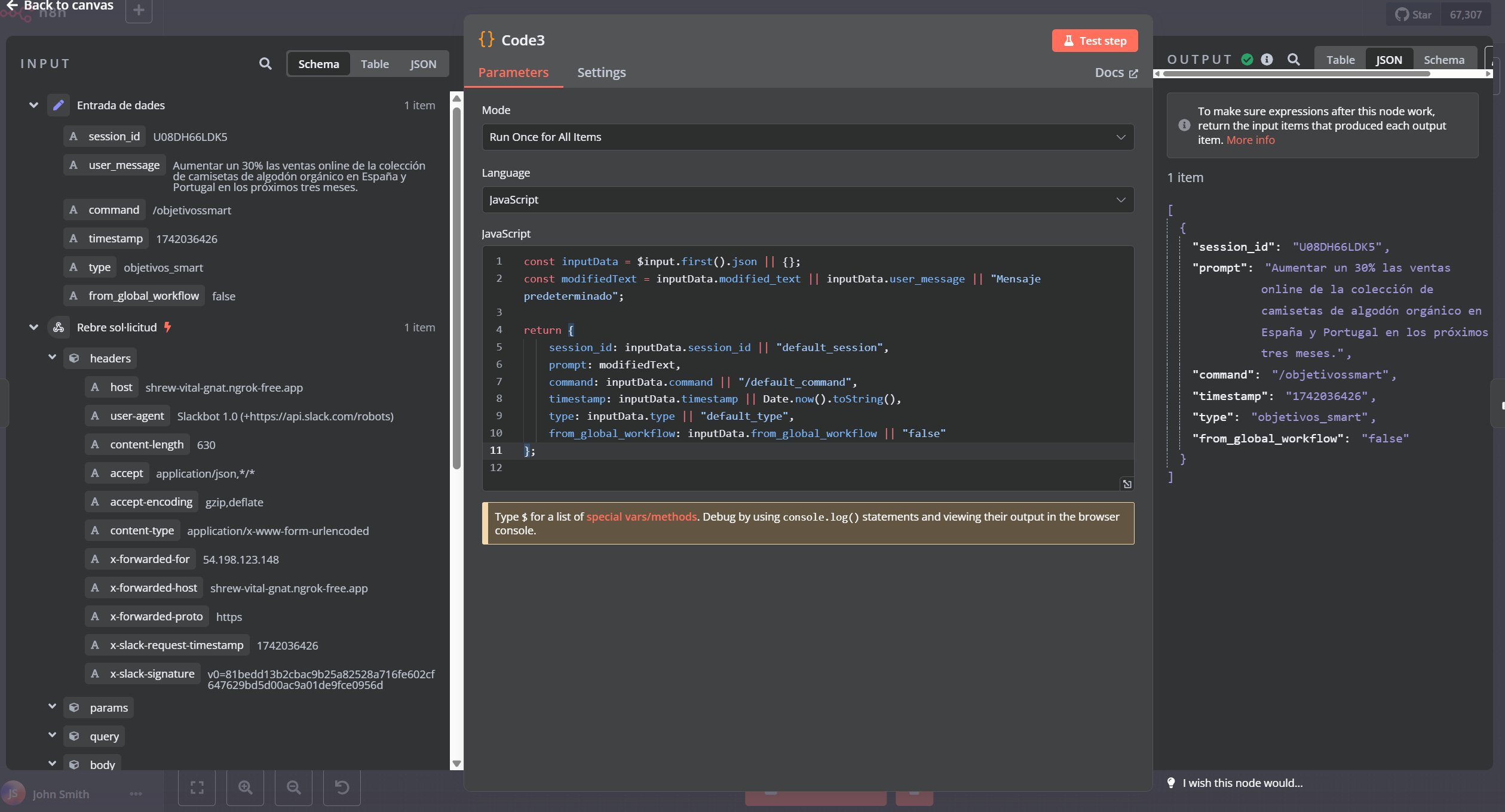

Initially, the loop went directly to the AI Agent, but this didn’t work (n8n showed a successful execution, but there was no output). To fix this, I added a Function node before the agent so that in the first iteration, it takes the original input, and in the following iterations, it uses the modified version.
:cross_mark: The problem persists: if the loop is active, the Function node returns nothing. If I remove the loop, everything works fine.
:pushpin: Is there a limitation with loops in n8n? How can I fix this without breaking the flow? :folded_hands:
With loop:
Without loop:

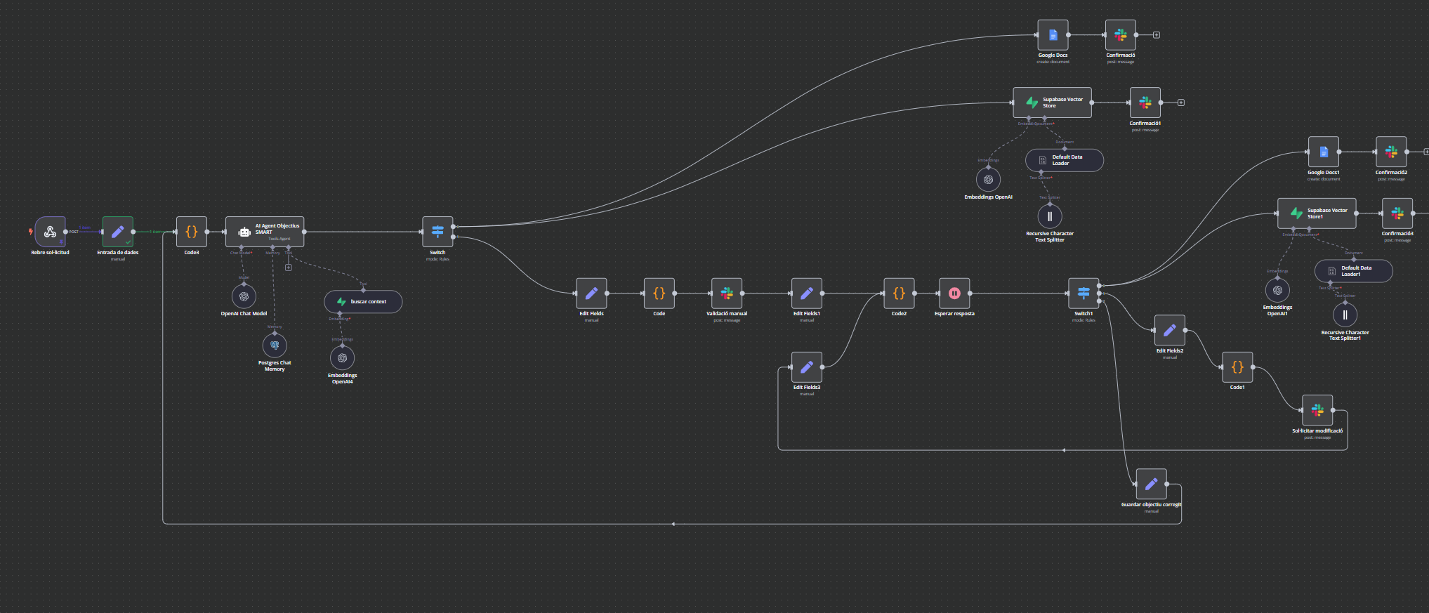

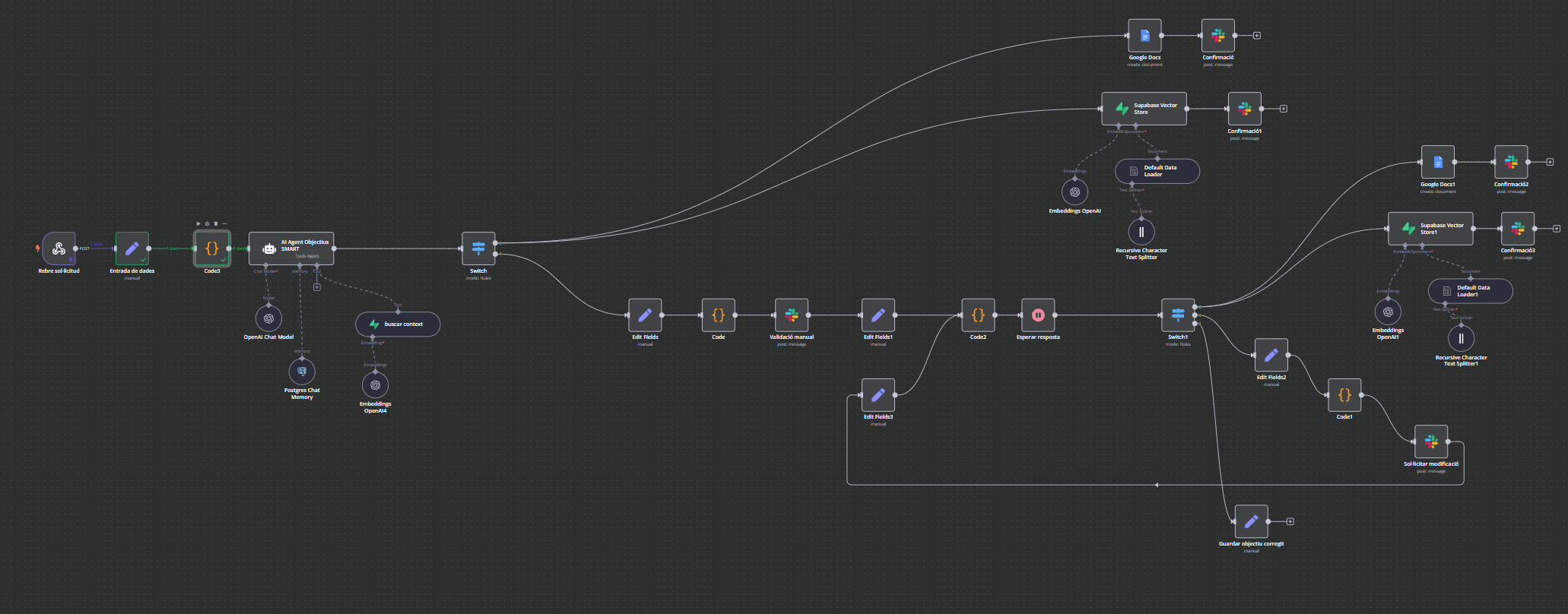

I have slightly simplified the workflow and added some sticky notes for better clarity. Additionally, I have removed or deactivated a few nodes to improve the overall setup.
Regarding the webhooks and resumes, there’s also the possibility of using a Human in the Loop node, which makes the process even more smooth.
