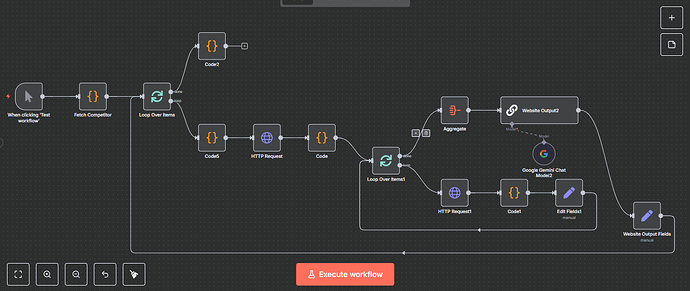

Hi everyone,
I’m currently facing an issue while working with nested loops in n8n and would love some help or confirmation if anyone else has experienced something similar.
The Problem:
  • I’m processing data in batches.
  • The first batch passes through the nested (inner) loop perfectly and returns the correct output.
  • But when the second batch enters the same inner loop, it skips the loop output and directly goes to the “Done” output.
  • Because of this, I don’t get the processed result of the second batch. Instead, the output seems to repeat data from the first batch.

I posted about this on Medium a whole ago. Hope this is helpful.
https://medium.com/@kyle.holder/learning-n8n-tips-for-navigating-loops-without-losing-your-mind-73c51d6b3f61
@Kyle_Holder Yes, it’s working. Thank you so much dear :heart_eyes:
