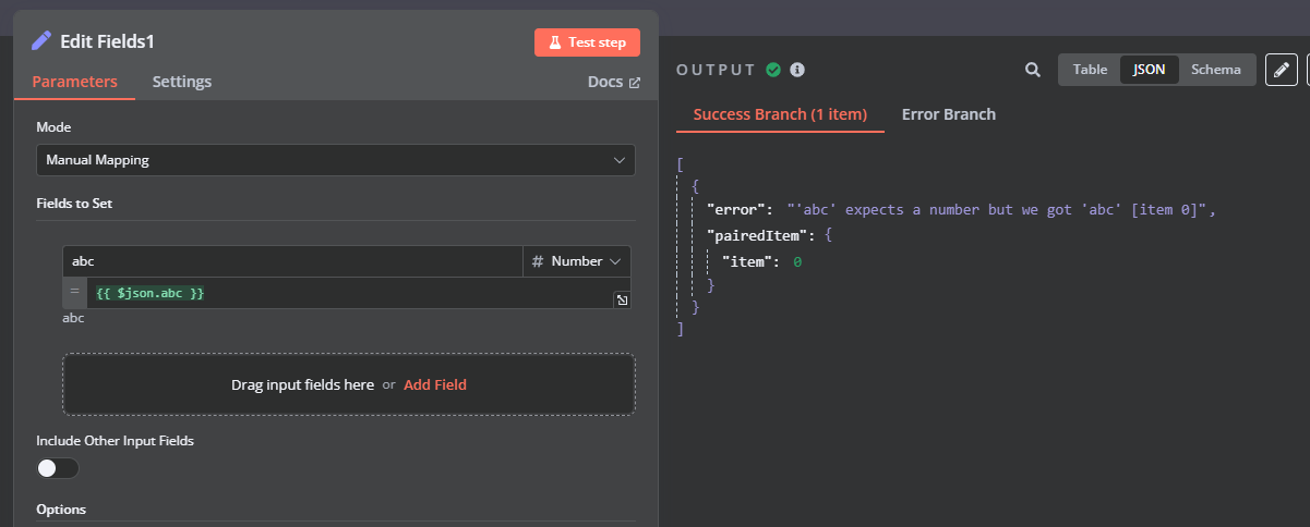

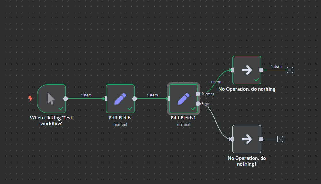

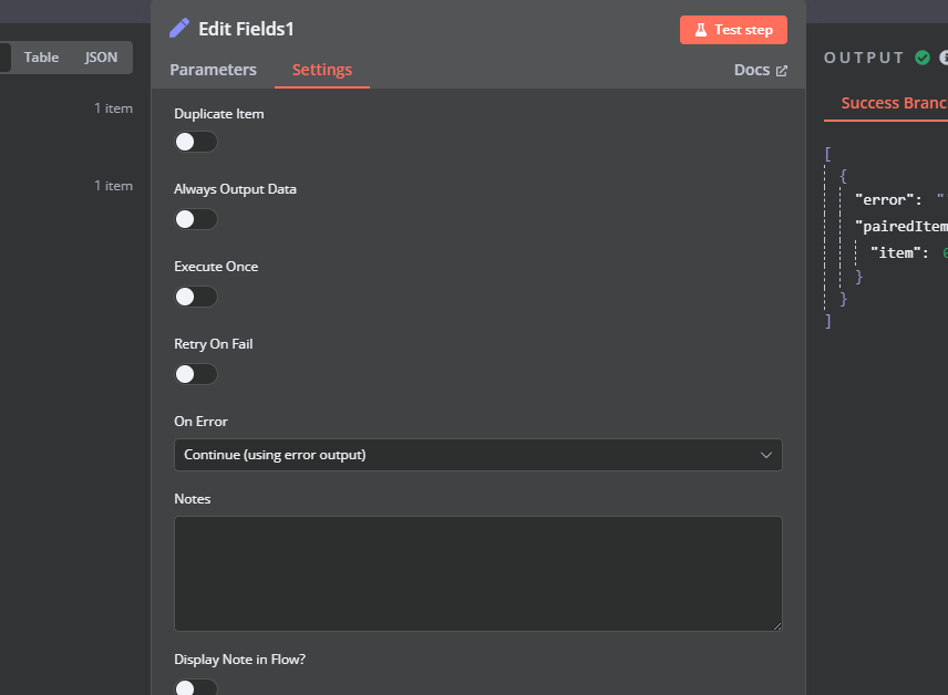

I noticed an issue when building a flow today. When I have the Set Node set to “Continue (using error output)” and the node errors it isn’t using the separate error output.

Can confirm this behavior. The If node behaves even weirder (it channels all errors to the false branch along with the items that properly fall there due to the condition).
Looks like the best workaround for now is add extra logic past the Set node.
Note that the If node in this example is configured to always return data to not stop the workflow if errors is all you have.
