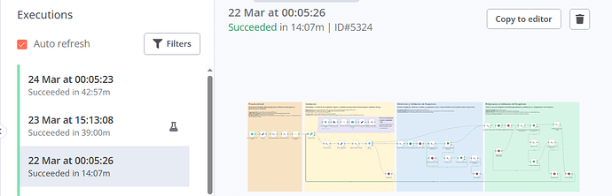

I’m facing an issue with the Execute Command node in my n8n workflow. The node connects via SSH to a remote server and executes a command. However, despite encountering an SSH connection error (as shown in stderr), the workflow is marked as successful instead of failing.
(I can only share an image since this workflow is private)
I have configured the node to retry up to three times on failure, but even after three retries, the workflow still completes successfully. Here’s the relevant output from the node logs:
“exitCode”: 0,
“stderr”: “Connection closed by 11.111.111.11 port 22”,
“stdout”: “”
