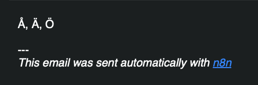

Tried both html and text mode for the following short WF and I receive emails just fine, the letters look exactly the same.

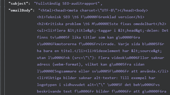

Unfortunaly no, can’t pin the Gmail-nod because it lies as a tool for the agent. but can show you an example of the output from the AI Agent. Looks like this:
And when it goes to the Gmail-nod to send, it looks like this:

Have tried both and same problem occurs :confused: Have used claude and chatgpt to create some form of UTF encoding, looks like this (Same code used but for a different subflow, that’s why you see another inputname)
// Explicit UTF-8 encoding för svenska tecken
const analysis = $input.all()[0].json;
// Konvertera till Buffer och tillbaka för att säkerställa korrekt encoding
const analysisText = typeof analysis === ‘string’ ? analysis : JSON.stringify(analysis);
const utf8Buffer = Buffer.from(analysisText, ‘utf8’);
const cleanOutput = utf8Buffer.toString(‘utf8’);
return [{
json: {
analysis: cleanOutput,
charset: “UTF-8”,
status: “completed”
