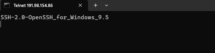

We can connect to it via CMD’s telnet client and winscp with no issue:
While I am based in Perú, that connection was achieved by a friend in germany, where I understand the current n8n hosting service is.

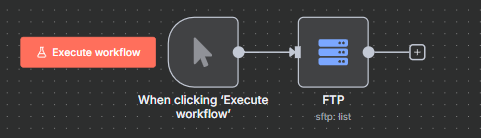

Ok, so to summarize, you are using cloud n8n and have an ftp server hosted somewhere in Peru (actually when I asked where, I meant the service - like in GCP, AWS, Azure, own VPS etc). Do you have access to the logs of this ftp server? If so does it reveal any insights about the nature of the disconnects? Can you try to list the files with FTP node? Something as simple as this:

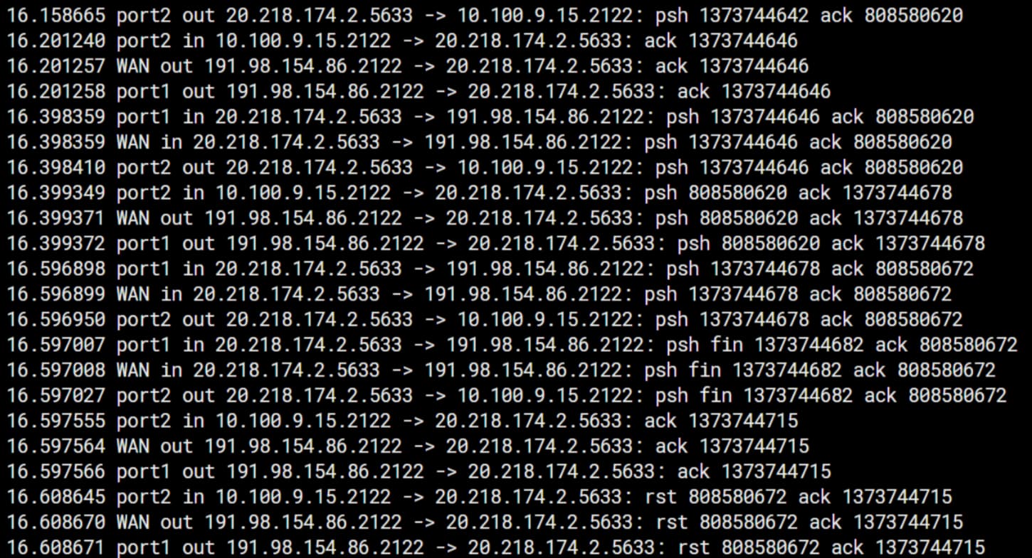

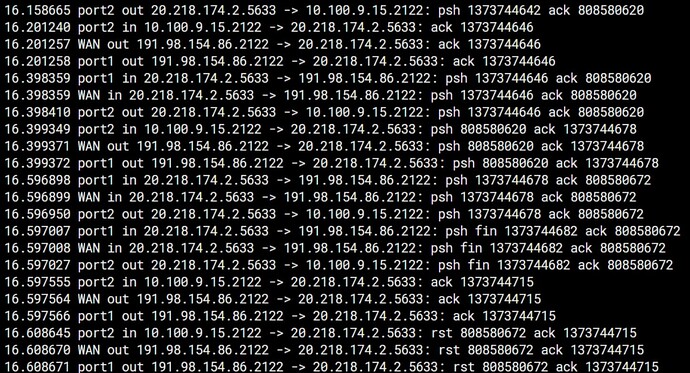

We don´t use a service, we use our own VPS. The logs are as follows:
showing a reset in the end.
The disconnects do not allow me to save the credentials and when I try to list the folder contents from the root, it returns error: read ECONNRESET.
Well, this isn’t really the ftp log, it looks like a traffic capture. While it is cool to see, we already knew that the traffic is reset by the ftp server. FTP logs (if enabled and set to be verbose) would indicate the FTP application level events, like - user attempted to connect, then what went wrong (permissions, folders that do not exist, …) etc…
Or it could indicate that FTP doesn’t even receive the packet - for example if the packet if blocked by the system firewall - you could see it in the packet capture, but not in the ftp logs.

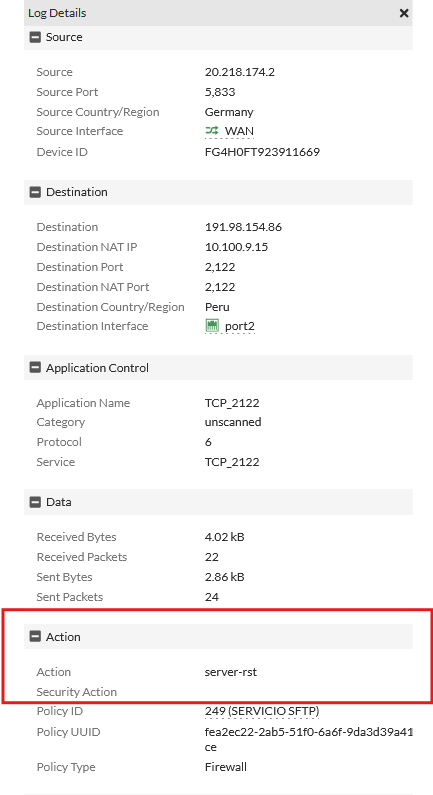

Did you mean this?
Now, this looks like a firewall log, if I had to guess - a Fortinet device. We can see the packet comes through from the WAN interface and undergoes DNAT (new destination is 10.100.9.15 and port is 2122). We also see that the action is server-rst, which means that the FTP server reset that connection.
All of that we already new (well except that now we are certain that the reset is not coming from the Forti firewall).

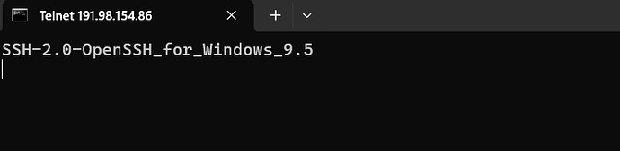

I looked at the image again and see that the banner that you get when telnet-ing to the server is SSH. Are you sure FTP is running on this port and not SSH? Is this for SFTP?

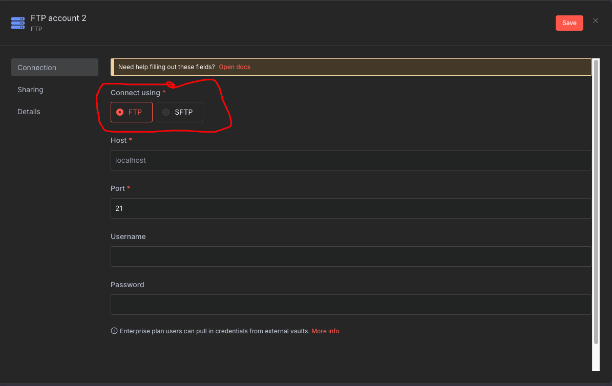

Which protocol are you choosing?
