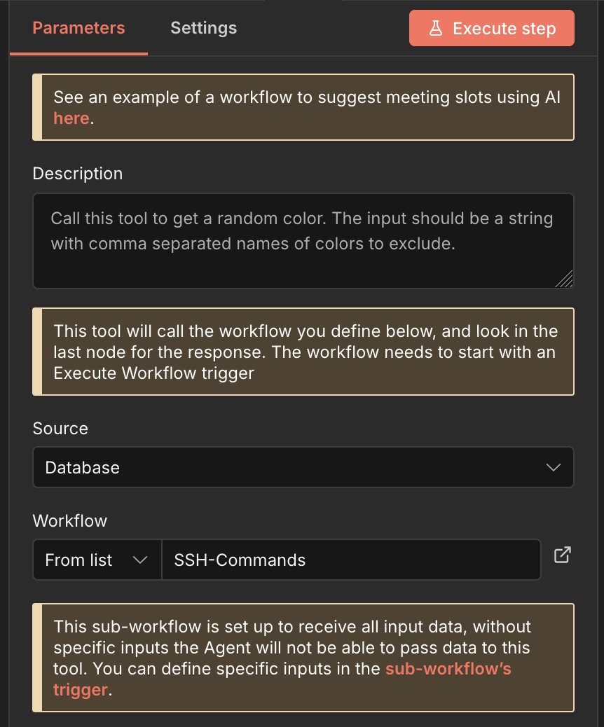

within here you choose a subflow call SSH_n8n_server, and it then should show you the commands within that flow but all I am getting is
This sub-workflow is set up to receive all input data, without specific inputs the Agent will not be able to pass data to this tool. You can define specific inputs in the sub-workflow’s trigger.
I have gone back through the video to check that I havn’t missed anything and I have even delete it and recreated it but I am still getting the same error.

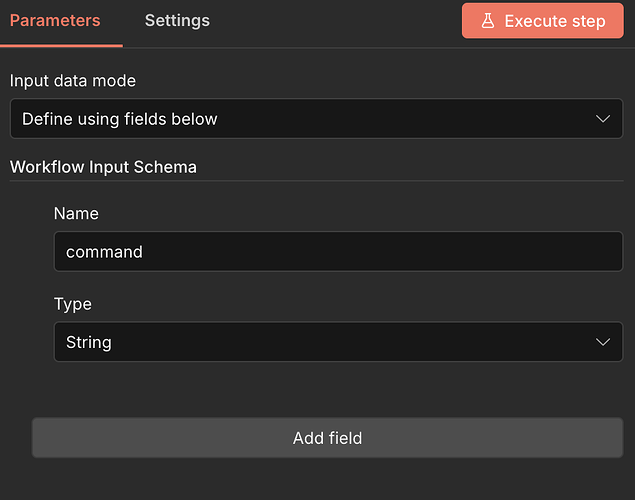

Your trigger in the sub-workflow is set to receive all data, which isn’t the case in the video. You have to define the parameter manually first, then you can see it when you add Call n8n Workflow tool.
Navigate to your sub-workflow, enter the trigger node, set th input data mode as Define using fields below and define the command parameter just as shown in the image and save the workflow.

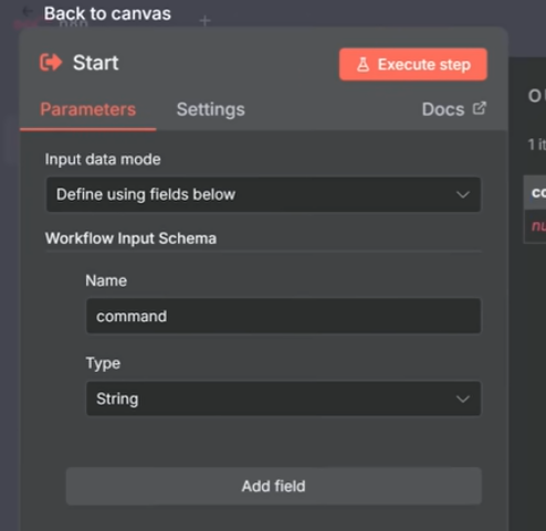

good morning I have set my start as follows
and when I run this I get a command of null, and then wilthin the excute a command I have drag over the input vaiable “command” and drop it into the command box.
but again, when I link this up I am still getting the after error

I’m having the same issue with the most current version of n8n. When attempting to call the sub workflow there is an error that is appears to show a bug:
The text: “This sub-workflow is set up to receive all input data, without specific inputs the Agent will not be able to pass data to this tool. You can define specific inputs in the sub-workflow’s trigger.” Doesn;t make sense, because the sub-workflows trigger is not in fact not set to “all input” but rather “Define using fields below” which is exactly what Chuck shows in his video.
Either way, regardless of the video - not able to trigger AI ssh commands which effectively halts my use of n8n until that is resolved. Love the idea of automating sysadmin tasks - but that starts with ssh access where we’re blocked.
I got the exact same problem, n8n is ignoring the custom workflow input scheme from the sub workflow.

I have noticed you can work around it by creating a new workflow, and then attach it onto the AI agent tool connection on the first workflow. Just make sure you publish the second workflow.
I will test thsi, thank you so much!
You need to publish the changes you made to the initial sub-workflow (SSH_n8n_server). Try creating “Call n8n Workflow Tool“ and adding your workflow from the list. It should show command now.
Initial sub-workflow is published when you create it from the canvas. But all changes need to be re-published.
That worked for me. Thanks.
Confirmed! As @mikam6a mentioned, that was exactly the issue. I didn’t realize I had to re-publish the sub-workflow after defining the input fields. Once I did that, the main workflow recognized the inputs immediately. Thanks! :slight_smile:
