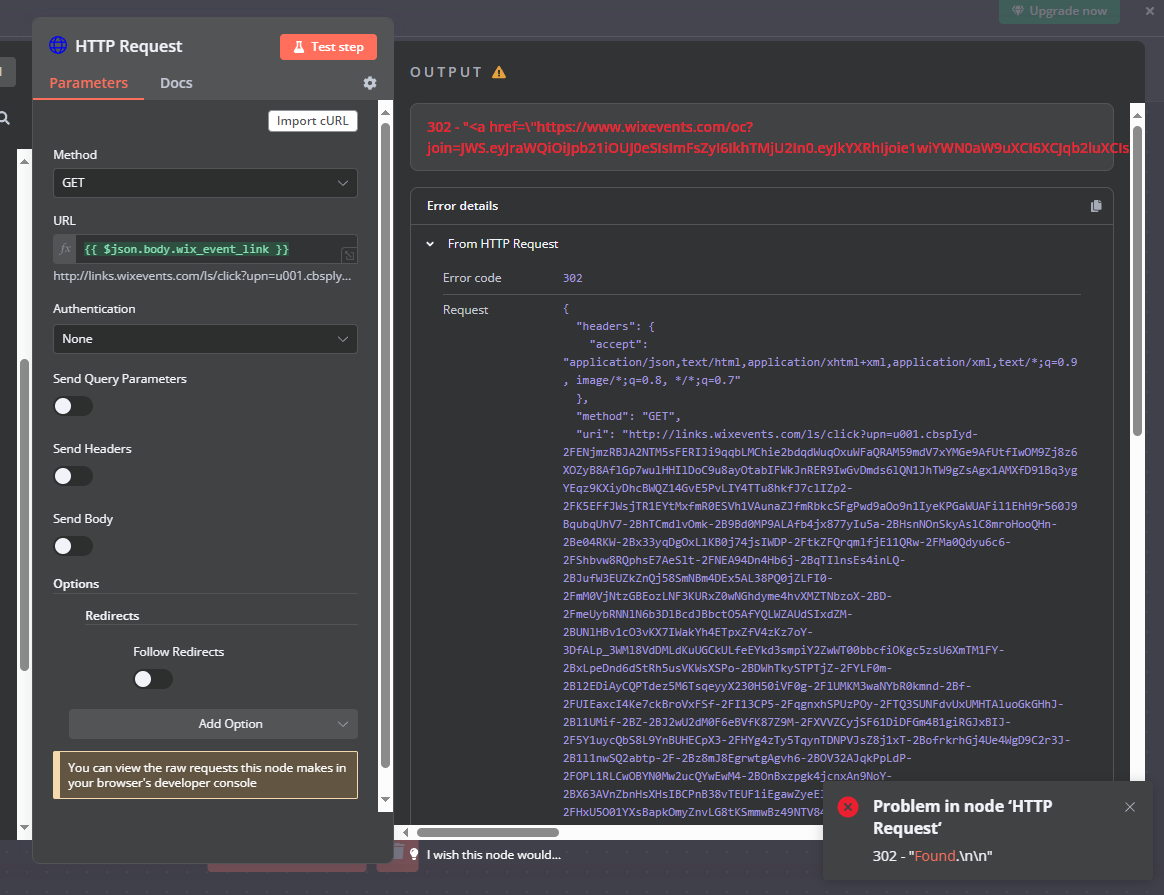

So my workflow is I get an email with a link to a zoom event, but its a redirected link from Wixevents.com. So I created a workflow where I can extract this wixevent link and use that to find the redirected actual zoom link. But I can’t make this work in here. I started with my webhook which gets the wixevent URL. Then I pass it to HTTP Ruquests, but it isn’t returning what I expected and I can’t get the link of it.

HTTP Settings
I am not sure what I need to change to be able to get the http://us06.zoom.com/abunchofnumbersandletters link.

@jlhsolutions , by following the URL you are getting the resource you are asking for with GET request, that is the content of the page; you will not get the URL you are redirected to this way. Try turning off redirect and see if the output can contain the redirect URL which you can parse.
@ihortom Ok I did as you suggested. Now I get a 302 error.

I’m afraid HTTP Request node does not have such a functionality built in. You would have to use custom code and self-host n8n to use it.
Ok. I was looking into the self-install. Would you be able to help me with the custom code you mentioned above?
Try the suggestion in node.js - how to get the landing page URL after redirections using axios - Stack Overflow.
