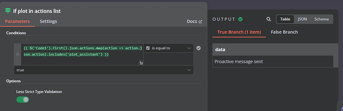

Hey, is someone able to explain whats happening with the if node here

Hi @BramKn
Thank you for your feedback here,

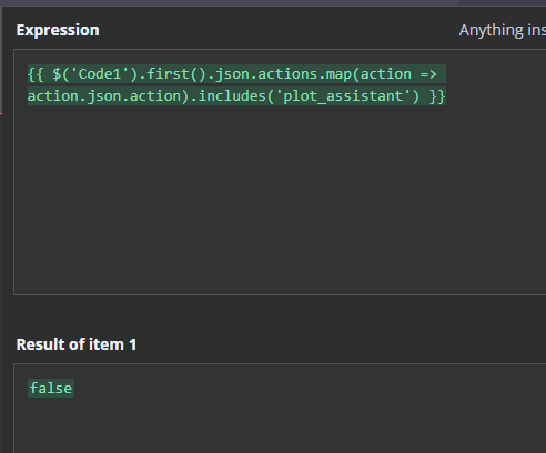

The code node returns and array of objects, im using the if node to check if any of the objects contain an action plot assistant, this expression works fine.
The issue ive got is with the if node, as you can see in the screenshot this expression resolves to false but somehow the output is true

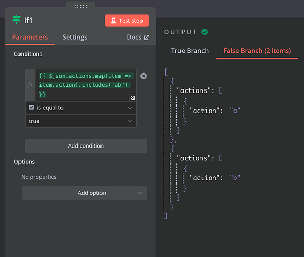

Hey @samp
You shouldn’t have to use the second .json in your .map() function.
So instead of
{{ $json.actions.map(action => action.json.action).includes('plot_assistant') }}
it should be like this:
{{ $json.actions.map(item => item.action).includes('plot_assistant') }}
See the example below which is working correctly:
