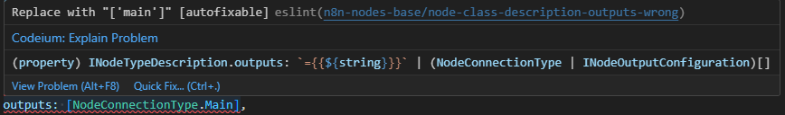

I get the following message when I use inputs: [NodeConnectionType.Main]
and this one using inputs: [‘main’]

After I made it work I realized the n8n-workflow package I used was outdated (some version around 1.42) and I updated to v1.82. With this update the linter didn’t liked using [‘main’] for inputs and outputs.
The solution was to also update eslint which seems to be obvious but I totally missed that possibility. Now it works with the NodeConnectionType Enum as expected.
