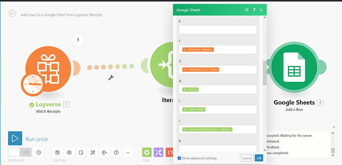

I have HTTP request and am able to pull all of my receipts from Loyverse. I need to put every item on a receipt on the GSheets, but I can only input 1 item on the GSheet per request from the receipt.
The result I am getting from Integromat (this info is enough thou)

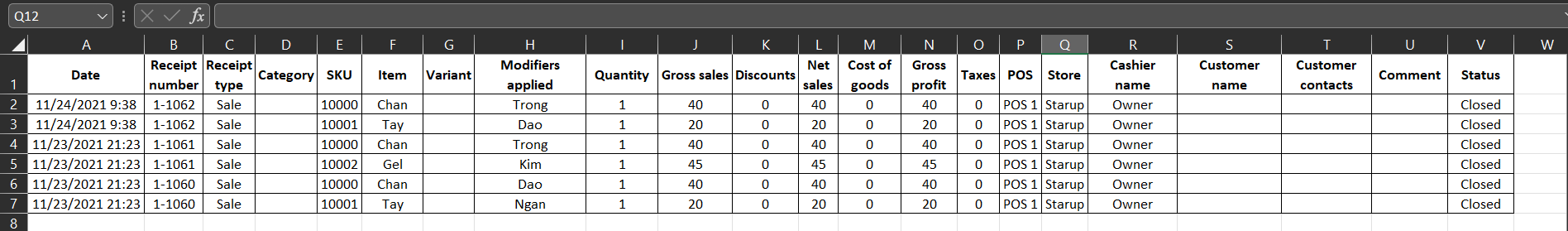

The result I really want ( the complete report from Loyverse)
Workflow from Intergromat

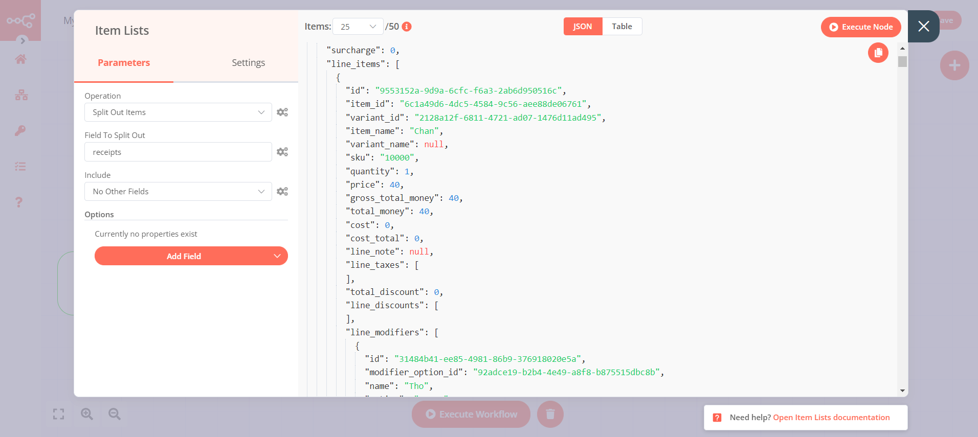

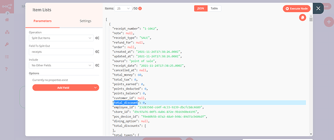

              You need to convert the receipts array into multiples items. Once you do that, n8n will do the iteration automatically for you. No need to use any of iterator. To do it, connect the HTTP node to the Item List node. In the Item List node select the operation Split Out Items and in the Field To Split Out field set the value receipts.

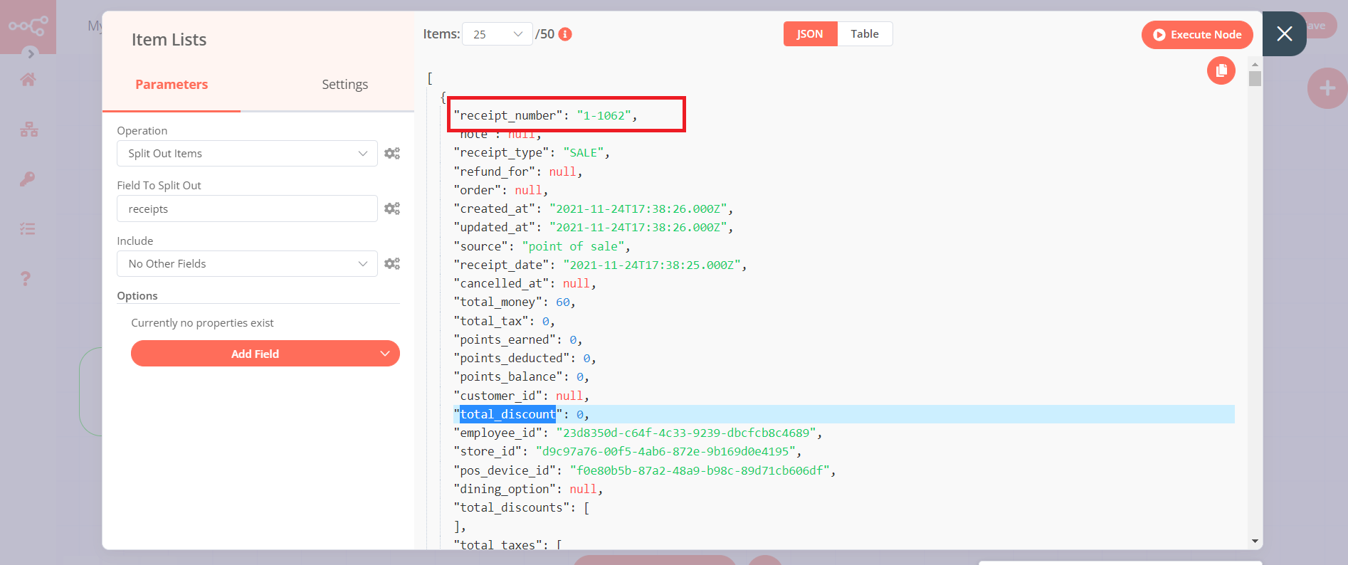

I’m able to pull out and put the 2nd line data (receipt_number,…) on the GSheets
but not from the 3rd line (data in line_items and line_modifiers) (hope this makes sense)

              Can you share the one item of the item lists’ output? Also what information from that item you need to save exactly in Google Sheets? With that information I can provide a better example.

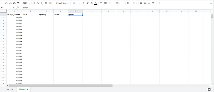

              Hi @RicardoE105, thanks for the answer. I want to pull out number_receipt, price, quantity, name, and option from the receipt data.
price and quantity are under line_items.
name and option are under line_modifiers.
I can only pull out receipt_number data and put on the Google Sheet.
How can I pull out all of them at once?
              Can you please share the JSON? Just one item.
