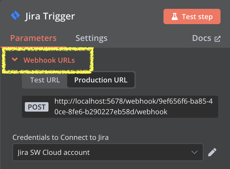

Can you check that you have set the WEBHOOK_URL variable correctly?
This should be reflected in the node’s Webhook URLs:
