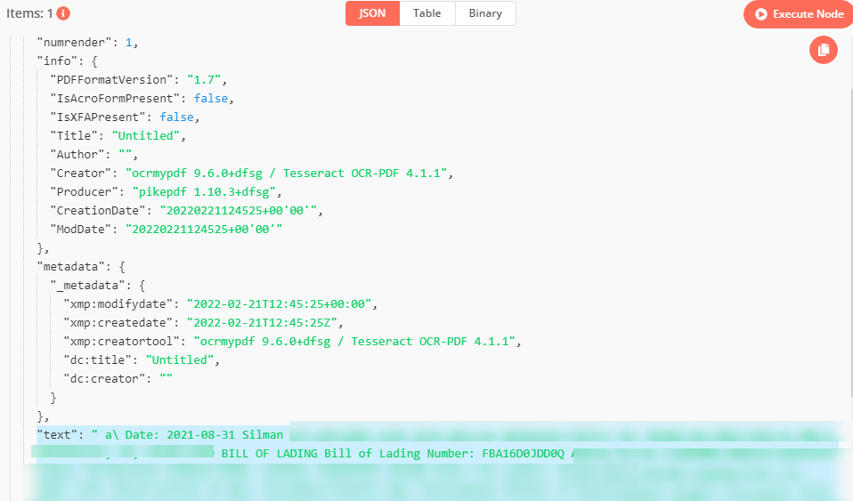

Hello n8n community,
As a result of reading a PDF the JSON output looks like this :
I need some help on how to target a specific text in value "Bill of Landing Number:"using the function node.
Thank you in advance.
I believe the way to do this is with a Set Node, you can call the JSON element ‘text’ just with {{$node[“Name of the node generating the JSON output”].json[“text”]}}. The use a RegEx to find the value that follows “Bill of Lading Number:”.
This would assume that the structure of your BOL is the same for each conversion , you might run into some problems if you are using BOL’s from different Carriers, for instance.
Refer to https://regex101.com/ to work out what your expression needs to look like, and there are a few useful beginner guides (Learn Regex: A Beginner's Guide - SitePoint) that have helped me build expressions with no prior knowledge.
You can then use the RegEx within your JSON expression with .match(), so it would look something like: {{$node[“Name of the node generating the JSON output”].json[“text”].match(/Your RegEx/)}}
Somebody else here might be able to steer you in another direction, but this is how I would tackle the problem!
Thank you for your replay @Felix_is_stuck
Yes the file is gonna have the same structure.
But the solution did not work for me.
This gave me the whole content of “text”. While as you can see in the screenshot i need to get a specific value it.
That’s correct, {{$node[“Name of the node generating the JSON output”].json[“text”]}} will give you the complete value. You need to add a RegEx formula to extract only the data that you want and add that formula by appending .match(formula) to your expression.
I suggest you start by reading the guide I posted above, it will help you to understand RegEx formulas.
@Felix_is_stuck
You are right, i got the output i was expecting.
Thank you so much
