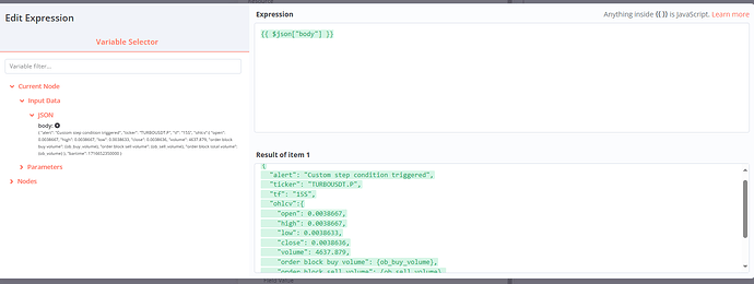

When I set the json command : {{ $json[“body”] }}
It give the information of the complete body.
But how can I filter this to just get for example ticker, or tf.

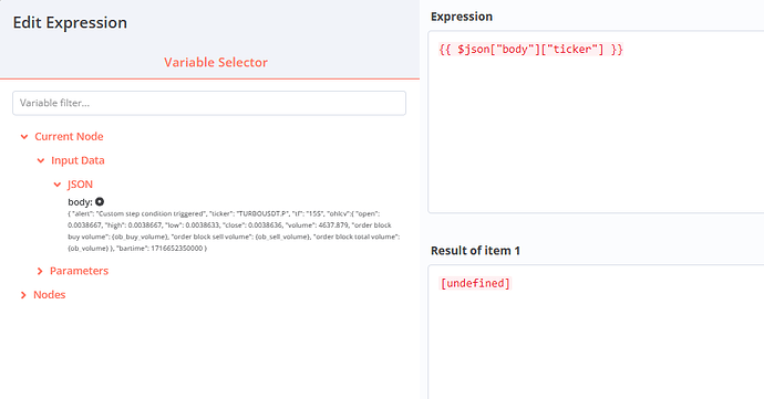

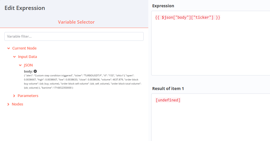

Hey, thank you for the reply.
I found these examples also in the documentation.
However on both I get an :
Result undefined.
So i’m missing something…

@mr.dipp , the value of body in your screenshot is a string representation of JSON, not JSON as such. You need to convert the string to JSON first.
{{ JSON.parse($json["body"])["ticker"] }}
