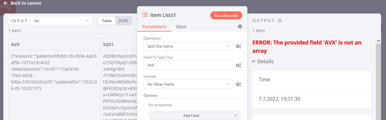

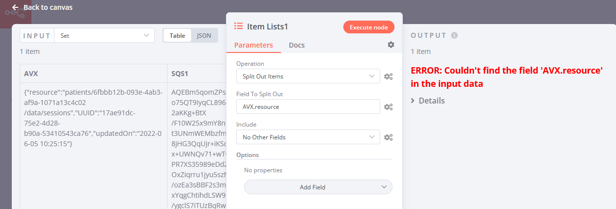

@BramKn it dont work, see here:
and here:
What i have to do ?
Hi @Stefan
Now you are dealing with different data.
the item Lists node I suggested because it can easily get data from arrays. Messages form the previous data set was an array.
You can get the data with the SET node or with a quick function node I created for ya.
