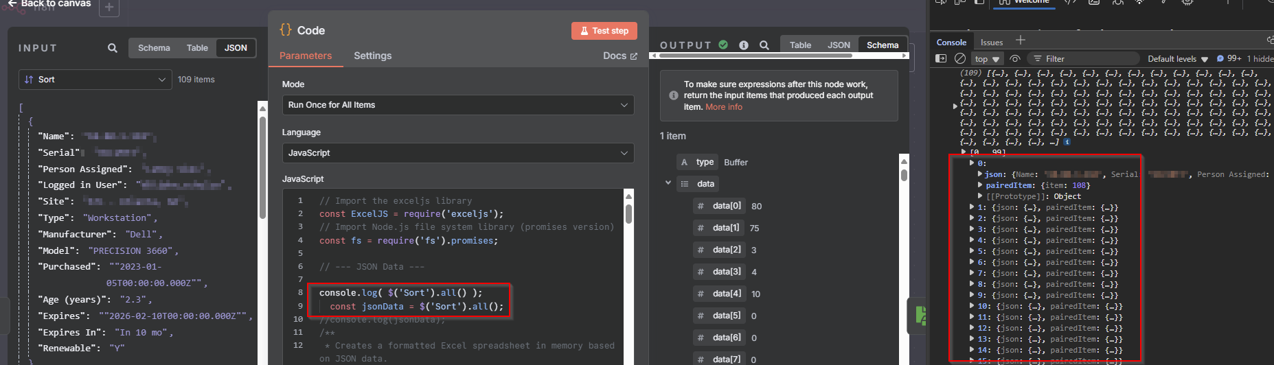

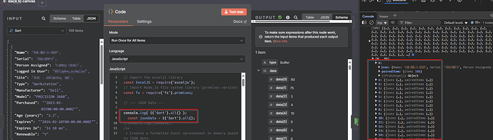

I’ve got a workflow that takes in some spreadsheets and converts it to JSON for processing. Part of the flow passes the data into a Code node for additional processing. I need the Code node to just get the JSON as shown in the Input window, but it’s getting the JSON formatted in JSON and pairedItem objects instead of the pure JSON data I need.
I’ve tried calling the data using several different methods, but it nothing seems to work the way I need it to.
The screenshot shows The INPUT window as I need the data, the Code window, and the console.log showing what I’m getting in the code node.
My question is - how can I just add/recall the JSON as it appears in the INPUT window in the Code node OR manipulate it in the Code node to get what I want?
