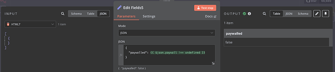

Json object is empty but node disagrees
I’m checking if the json has a field using $json.hasField(“paywall”) and the expression returns the correct answer but somehow the output doesn’t. Is this a bug or am I missing something?

Interesting.
I wonder if false is not actually parsing as falsey, there may be extra characters for some reason. Can you try set the object type from Boolean to String and see if it retains the value? (Not saying this is solution, just want to see if that changes the output)
Tried, didn’t change the output. Also tried going with JSON, same result.
  "paywalled": {{ $json.hasField("paywall") }}
Perhaps try:
$json.paywall !== undefined
or
('paywall' in $json)
Yeah that worked, thanks!
Awesome I am glad! Would appreciate if you could mark my response as the solution :slight_smile:
Sure! It did solve the problem but I hope the devs take a look at it tho since it’s probably a bug no?
Anyway, thanks again
Awesome I am glad. I am unsure, it may in fact be a bug. There are no bug reports for this on github tho. GitHub · Where software is built
The function exists in the documentation, but I have not used it before to confirm. You may be right. What does the input data look like exactly?
