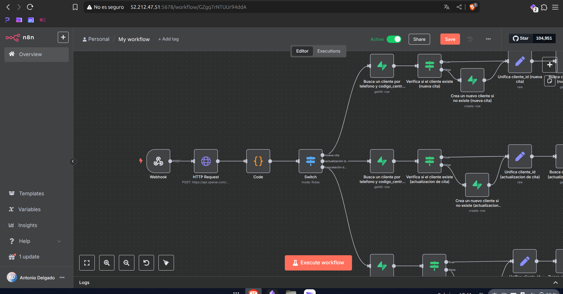

I’m working on a workflow to process emails for beauty salon appointments, and I’m stuck on an error in the HTTP Request node: “JSON parameter needs to be valid JSON.” I’d really appreciate any help!
My setup uses n8n with Postmark, ChatGPT 3.5, and Supabase. The workflow:
  1. A Webhook node receives emails from Postmark (e.g., to 44667.ESP@recordatorioswhatsappbelleza.com).
  2. An HTTP Request node sends the email to ChatGPT to extract details (client name, service, date, etc.) as JSON.
  3. A Code node processes the response, and a Switch node routes based on appointment type (new, update, or cancel).
  4. Supabase nodes store the data.

Hey @recordatorioswhats ,
I totally understand why you are getting this error, we can resolve the error that you having.
but before that I would suggest you to use n8n’s pre built node to make an api call to openai, it will be a lot easier for you to work with this node.
Just try this and let me know if it works for you.
but still if you want that you want to make the call via http node, than please keep a note of this..
in json format we cannot have line breaks, if we add them, than it will start showing invalid json.
So why it is showing invalid json is due to fact that the html body you are referencing from the last node must have line break, different paragraphs.
that’s why we have to convert all the inputs to json string so that it should work .
Copy the below and use it inside the content of http code node.
Destinatario (To): {{ $node["Webhook"].json.body.To || "unknown" }}Cuerpo del correo: {{ $node["Webhook"].json.body.TextBody.toJsonString() || $node["Webhook"].json.body.HtmlBody.toJsonString() || "No body available" }}
