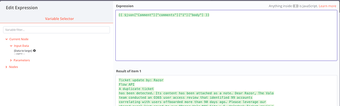

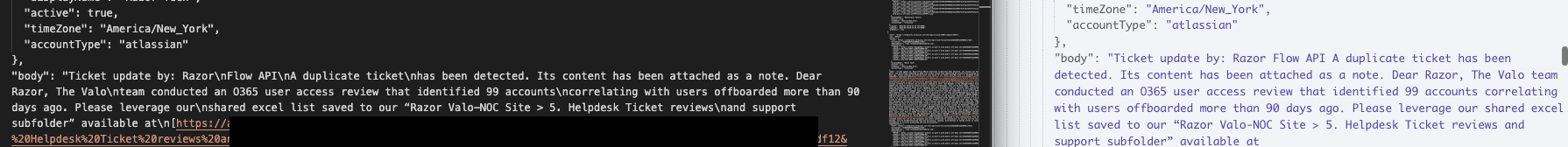

I am having a weird problem where if I copy the top level [ ] of the JSON and paste it into VSC it shows the payload with proper validated format line breaks etc. If i break the same element out in N8N and/or pass the element it formats the element based on what it has in the payload, but i just want to pass it the way it comes in because it’s breaking when i try to pass it formatted.

I guess I am having issues trying to explain the problem, but it’s mostly how its coming formatted. At the top level of the JSON payload [ … ] it has the payload elements the way its properly validated including line break tags and formats, but when i just pass the element itself it comes through formatted (line breaks injected and other illegal characters) which is not valid JSON. I guess is there a way to pass the JSON string exactly how its coming in without it being formatted?

@Jon - I agree it shouldn’t be formatting it. Maybe I am passing it on incorrectly. When I call the JSON element as an expression it’s bringing it over formatted and not as the original JSON format.

Looking at that the front end is just displaying it in a friendly way it looks like everything is still there for it to be displayed like that though.
Have you tried firing the request off to webhook.site or similar to see how it looks there? Maybe stringify might help?
