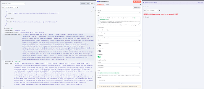

For some items I get an error JSON parameter need to be an valid JSON. However when I validate the JSON on external validators it’s evaluated as valid. When I load the value in the node as fixed I get no error. Many of the Items just work and have no error with the same set-up. I have no indication anything is different for the JSON values that give the error.
  • n8n version: 1.27.3
  • Operating system: linux
After a lot of digging it seems its the \n new lines causing this.
Hi @joschatje
i got it what might be the problem.
for WooCommereceProduct.json
in set node you have its datatype set as string, try changing the datatype in set node, change it to something else.
it will work , if need more help
copy and give me input.
Thanks! This helped
