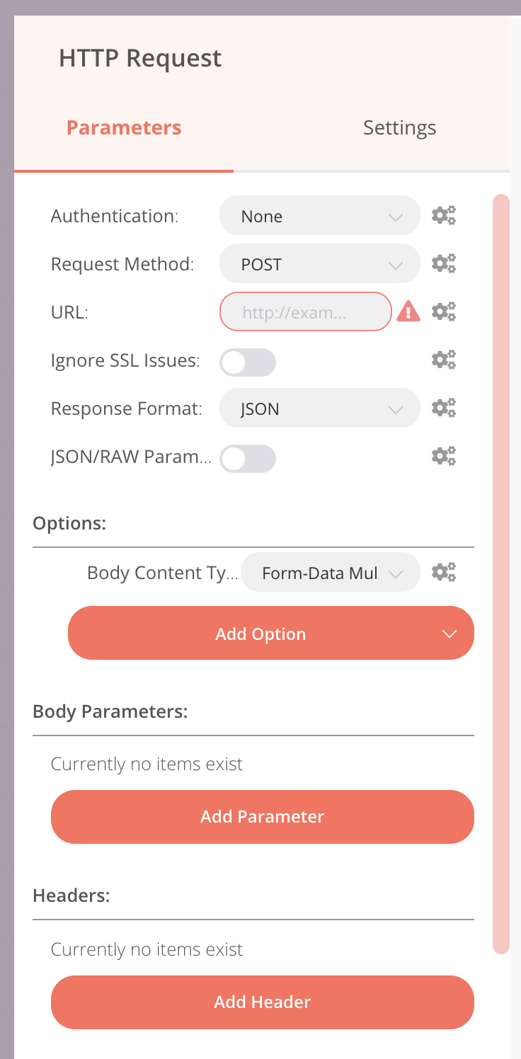

Ok, comparing the requests made by postman and n8n, there are a couple of differences:
- The n8n request does not include a user-agent. You can add this in the header as well.
- The n8n request uses content-type application/json whereas Postman uses multipart/form-data. To use multipart/form-data in n8n, check the image below.
and there you go the answer…multi-part versus json payload…bins are the best method to SEE the error
Wow. Problem solved!
Thank you both for your help!
Have a nice one!
Can you share what solved the issue exactly?
Yep!
I just added hearder with user-agent and checked multipart/form-data in the Body Content-Type!
you will not need user-agent
