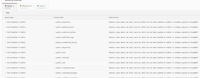

I’m using n8n on Render (free tier) with Supabase for a persistent Postgres Back-end.
I got dozens of security warnings from Supabase that all calls n8n Render were not safe (as RLS was not defined with some form of Authentication (e.g. JWT…).

Can you share some screenshots?
I’ve never seen those warnings and I use Supabase credentials and Postgres credentials with n8n.

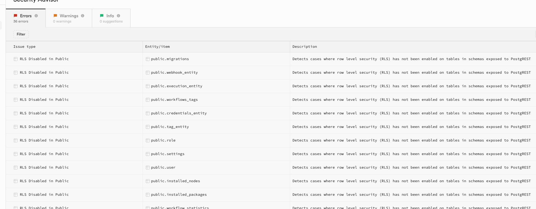

Sure - her’s both: the security warning mail I got from Supabase, and a screenshot of a fraction of the 36 warnings (same issue)
I can enable RLS on supabase but that means shutting out n8n unless some Auth is set up. So that’s the essence of my question: what is the best (safest) practice here?
