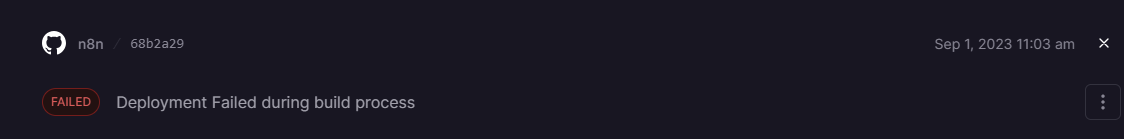

Hi @jan
This doesn’t seem to be working and my build fails on redeploy, anything else you can recommend please?

When I try to add the persistent volume using this path, the redeployment fails.
I’m using “FROM n8nio/n8n:latest”
Is there maybe an environment variable I need to add to get this working?

@Jon deployment failed during build process, no deployment logs, only build logs:

Hey @Wayne,
The build shouldn’t fail becuase of that, Do you have a way to get more logs as that looks like the build was ok.
@Jon Not that I can see, only this: No deployment logs. All output sent to stdout will be displayed here
How do you know it failed? The log suggests it was all good.
@Jon Railway is displaying a failed message and it didn’t upgrade to the latest n8n version until I removed the storage:
Hey @Wayne,
It could be worth asking Railway if they can clarify what the issue actually is, It could be that they have an issue with the storage or it doesn’t work as we expect it to.
