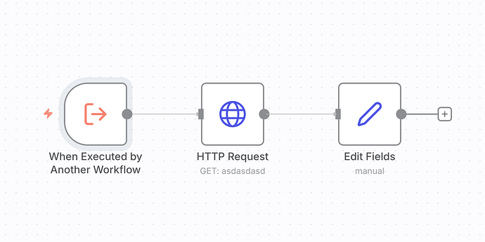

One way to approach this would be to use a sub-workflow, that way you can use a “Edit fields” node to remove all the unnecesary JSON and return only the data you’re interested in.
Would look something like this:
You can use the sub-workflow with the “Call n8n workflow tool”
Thank you this is best option
