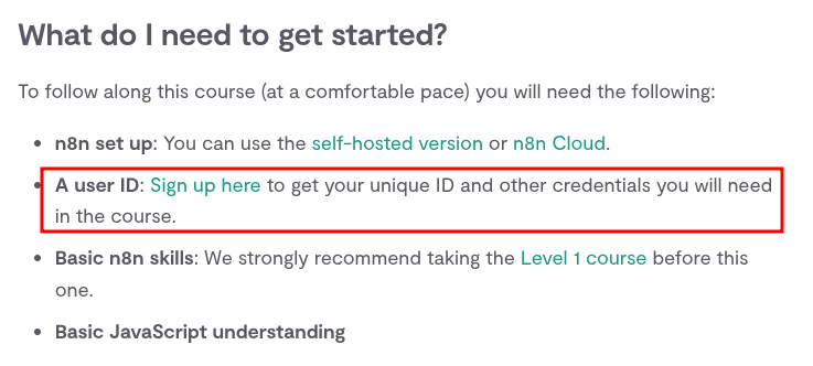

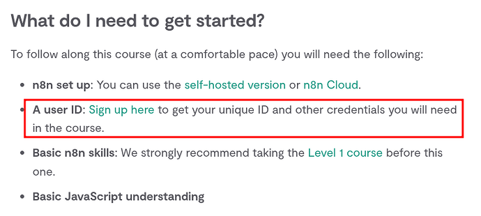

It’s because you keep using your ID from level 1 course and you didn’t register for the second course:
In my case, I have two mail with the same ID but webhook and URL are differents
