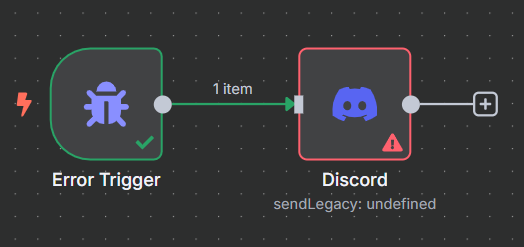

Following the level 2 n8n course and at this part: Workflow 3 | n8n Docs
I am unable to submit the Discord message in the error workflow. The same credentials for the previous two workflows worked fine so I do not believe it is an authentication problem. Possibly there is a character limit being hit?
Using the exact same node, if I send a shorter message it seems to go through without issue.
Stack trace
NodeOperationError: at ExecuteContext.parseDiscordError (/usr/local/lib/node_modules/n8n/node_modules/.pnpm/n8n-nodes-base@file+packages+nodes-base_@aws-sdk+credential-providers@3.808.0_asn1.js@5_12b981d6b49d407a163f4d5244314033/node_modules/n8n-nodes-base/nodes/Discord/v2/helpers/utils.ts:82:9) at ExecuteContext.execute (/usr/local/lib/node_modules/n8n/node_modules/.pnpm/n8n-nodes-base@file+packages+nodes-base_@aws-sdk+credential-providers@3.808.0_asn1.js@5_12b981d6b49d407a163f4d5244314033/node_modules/n8n-nodes-base/nodes/Discord/v2/actions/webhook/sendLegacy.operation.ts:153:34) at processTicksAndRejections (node:internal/process/task_queues:105:5) at ExecuteContext.router (/usr/local/lib/node_modules/n8n/node_modules/.pnpm/n8n-nodes-base@file+packages+nodes-base_@aws-sdk+credential-providers@3.808.0_asn1.js@5_12b981d6b49d407a163f4d5244314033/node_modules/n8n-nodes-base/nodes/Discord/v2/actions/router.ts:70:17) at ExecuteContext.execute (/usr/local/lib/node_modules/n8n/node_modules/.pnpm/n8n-nodes-base@file+packages+nodes-base_@aws-sdk+credential-providers@3.808.0_asn1.js@5_12b981d6b49d407a163f4d5244314033/node_modules/n8n-nodes-base/nodes/Discord/v2/DiscordV2.node.ts:33:10) at WorkflowExecute.runNode (/usr/local/lib/node_modules/n8n/node_modules/.pnpm/n8n-core@file+packages+core_openai@4.78.1_encoding@0.1.13_zod@3.24.1_/node_modules/n8n-core/src/execution-engine/workflow-execute.ts:1187:9) at /usr/local/lib/node_modules/n8n/node_modules/.pnpm/n8n-core@file+packages+core_openai@4.78.1_encoding@0.1.13_zod@3.24.1_/node_modules/n8n-core/src/execution-engine/workflow-execute.ts:1536:27 at /usr/local/lib/node_modules/n8n/node_modules/.pnpm/n8n-core@file+packages+core_openai@4.78.1_encoding@0.1.13_zod@3.24.1_/node_modules/n8n-core/src/execution-engine/workflow-execute.ts:2100:11
The message I am trying to send is:
The workflow {{ $json.workflow.name }} failed, with the error message: {{ $json.execution.error.message }}. Last node executed: {{ $json.execution.lastNodeExecuted }}. Check this workflow execution here: {{ $json.execution.url }} My Unique ID: [hidden]

I encountered an issue in the second workflow. I tried the same solution in the third, but it didn’t work in the end. Regarding the Discord channel, either lots of people are struggling, or it just doesn’t work. Since June 26th, I haven’t seen any messages on the Course 2 channel about workflow errors.
In my case, I reused the message from workflow 2 and it worked.
I think the Discord message check for this final part isn’t adapted to this text.
The workflow {workflow name} failed, with the error message: {execution error message}. Last node executed: {name of the last executed node}. Check this workflow execution here: {execution URL} My Unique ID: ….
Did anyone figure out the actual issue?
How did you manage to do it? Just sending the 2nd message didn’t work out
Did you figure out somehow? Since you’ve got the badge now
Try exact below (Hope this is not a PreRequisite for a Badge)
I sent the file using email with the label ID [This Message is to make it work somehow]. The workflow {{ $json.workflow.name }} failed, with the error message: {{ $json.execution.error.message }}. Last node executed: {{ $json.execution.lastNodeExecuted }}. Check this workflow execution here: {{ $json.execution.url }}. My ID: <Replace_With_Your_ID>
