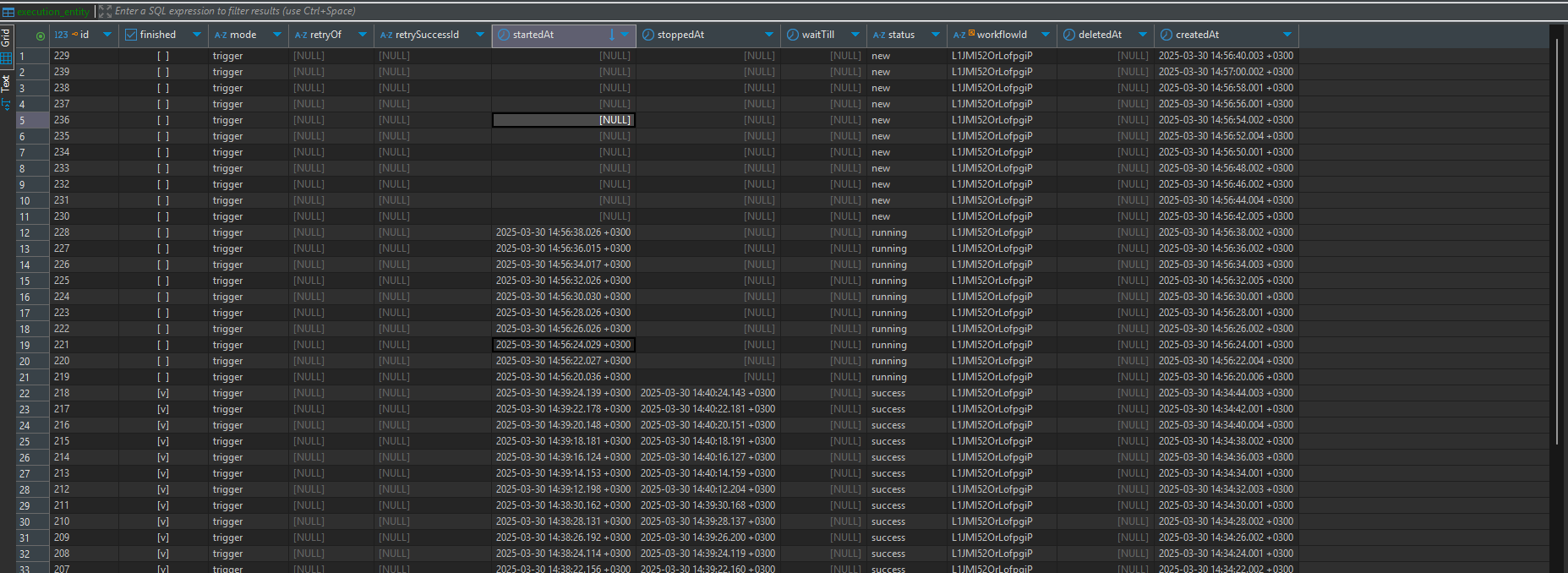

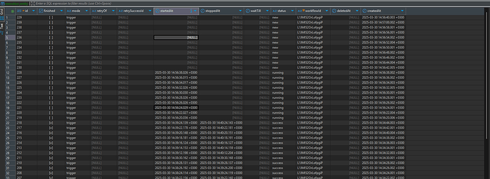

Hi, i think this is just part of the architecture I suppose that this is because of the need to be able to handle both worker and non-worker scenarios. As far as I can see, the API only offers failed, completed and waiting states as a filter. (this stems most likely from the fact that n8n polls the queue state periodically : like 20s default. and there is no way for it to know when workers actually pick up work, however the workers do track state through the DB) . full execution data is available through the DB itself… :slight_smile:
there is new which most likely means, waiting in queue terms and running well some worker picked it up.
I don’t really think its meant to be used like that. but if you need it knock yourself out by reading the db directly… that is, if you are self-hosted …

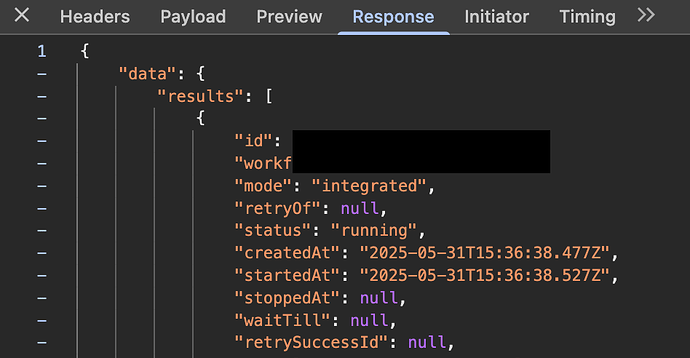

UPDATE : it looks like it is available in the UI because the UI is making a call to /rest/executions?filter=…
which gives back data like :
where you can see a status = “running”.
But (assuming it is what needs to be used) how can you use it inside a n8n workflow ?
