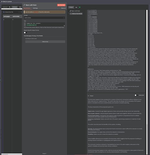

@ramblingnate Doesn’t see what? Again, you can only pass text to text only models. Trying to pass pdf, HTML or any other document file wouldn’t work because those are binaries. So you’d need to convert them to text first and then pass that text to LLM. Here’s an example with a PDF and llama3.1:
The workflow fetches PDF using the HTTP Request node, extracts the text from PDF, and then passes the text to the Basic LLM Chain for summarization.
