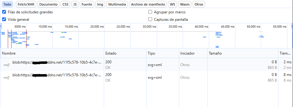

No message is displayed in the Chrome console. I don’t find any explicit webhook calls in the network section. I assume the request is being made by Telegram in the backend.
I was assuming the request made it to your webhook, does it not? Do you get errors on n8n when the webhook is triggered via an event on telegrams end?
No calls are being received from the webhook, however, other calls to the same subdomain do come in. The image shows a call to retrieve an image. I assume the webhook calls are made on the same port 5678. I currently have the external port 443 redirected to the internal port 5678 on the router, and with this configuration, n8n works correctly. I assume Telegram also sends calls to the webhook through port 443.
N8n doesn’t throw any errors, it just waits until I stop it or it times out

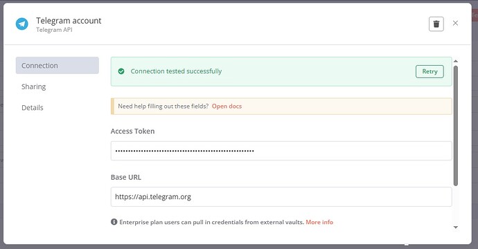

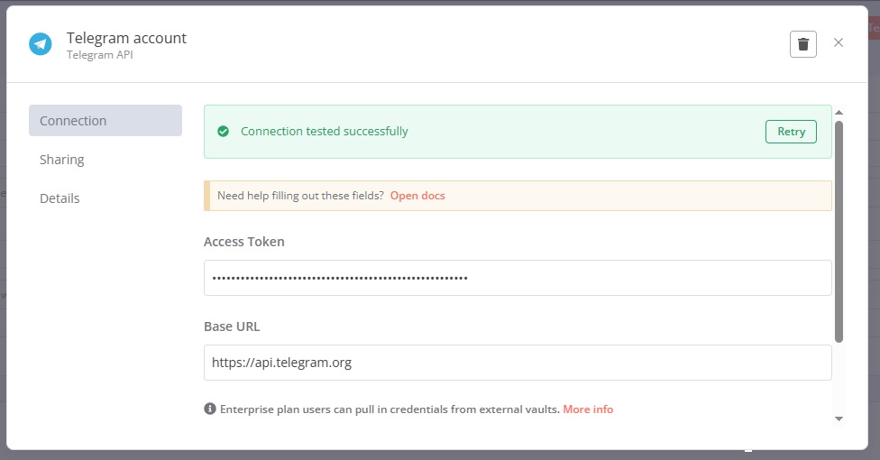

The Telegram credentials are also configured correctly.
I’ve also tested two bots, one of which I’ve also tested on n8n cloud, and it works perfectly.
