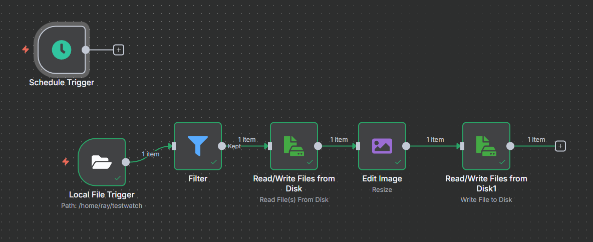

This is what I got - I added Schedule - but unsure how to ‘connect’ it.

You can simply activate the workflow and it will keep checking
That’s what I thought too - and… I swear it didn’t work. I tried one more time to be sure… and it works. Thank you!
