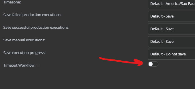

Please go to your workflow settings:
See if you have enabled a limit to the workflow timeout. This should be disabled.
Yeah that’s already disabled. The workflow itself doesn’t time out. It completes its work, but it appears that some request that the chat UI is making must time out and then it never receives the result back from the workflow.
