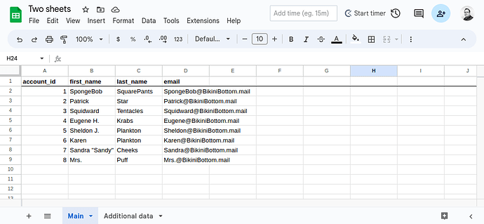

So let’s unpack this here. Seeing you haven’t shared your workflows or example data I will use the below example document for such a job and make some assumptions. You would of course need to adjust this to match your own document structure and replace any IDs as needed
Example document
Sheet “Main”
Sheet “Additional data”
Existing logic
You can already add data like so and I reckon you are doing something along these lines based on your description:
The workflow would produce the below result:
Updated logic
Now to lookup data from the “Additional data” sheet, all we need is two more Google Sheets nodes: One to perform the lookup (using the Read Rows operation and the Filters option), and one to update the “Main” sheet in this example. Here is how it could look in a workflow:
This workflow will now look up the additional details from the second sheet (an email in this example) and update the first one:
