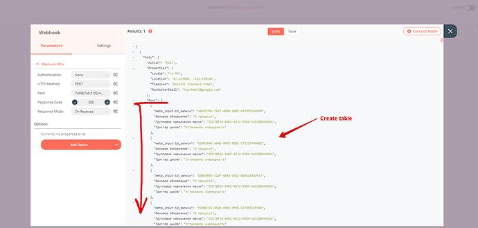

I have a JSON payload like this.
  1. I need to create rows from all the “Rows” elements with the names of the columns from these elements (please help).
  2. Send this whole table to Google table (I know that).
  3. Based on the created table, send a separate request for each row to another service (how to loop or something like that).
  4. So iterate over all the lines and believe the answer to the entry point from the first JSON (please help).

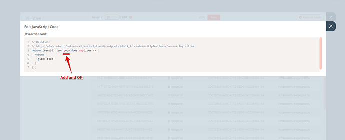

All you have to do is to convert the data underneath “Rows” into separate items. So with a Function-Node with the following code:
// Based on:
// https://docs.n8n.io/reference/javascript-code-snippets.html#_1-create-multiple-items-from-a-single-item
return items[0].json.Rows.map(item => {
  return {
    json: item
After you did that everything else will be easy. You can simply follow the documentation for the Google Sheets node to append the data and also the one of the HTTP Request Node. n8n will iterate automatically over all the items.
Thanks Jan
Yes, it works, just added the “body” correction to the code.

Ah yes makes sense! Did see it wrong in the picture.
