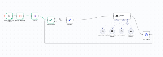

My loop node doesn’t give any output although it does get input. It stops the whole workflow.
The error message is that the edit field node can’t execute because it’s missing input from the loop
I believe this is because you have to complete the loop with the loop node. It wont ever proc the done branch because it could not complete the loop.
I am unsure if done branch to same route is accurate, but you have to at least connect the end http request back to the beginning of the Loop Over Items node. Like this:

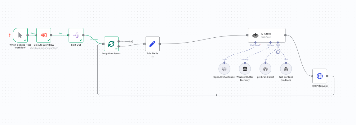

Thanks for your feedback. I’ve tested your solution, but it still has the same error. Here’s the adjusted workflow, it still has the same issues.
What errors are you seeing exactly, maybe I don’t follow? Could you provide any screenshots?

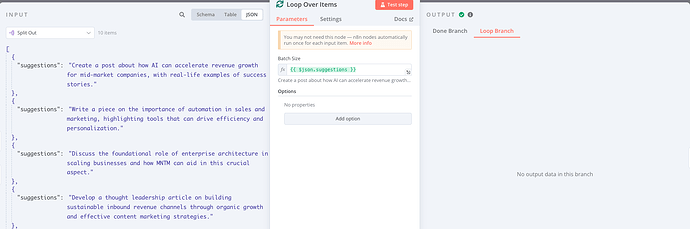

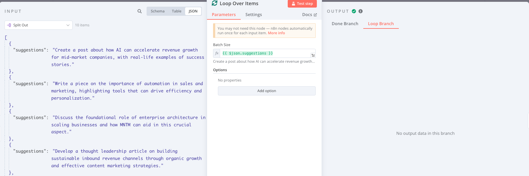

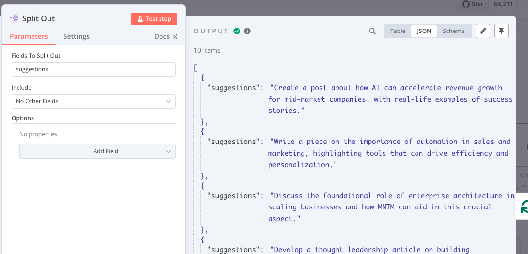

The Loop node receives input, but he doesn’t create output for the edit field node to execute. I’ve uploaded screenshots of the Split out, the Loop node & the test workflow to show that the workflow stops at Loop Over. I hope that helps.
Oh. Loop Over Items node batch size should just be set to 1, not {{ $json.selections }} .
that was simple! Thanks, that solved the issue, appreciate the support!
