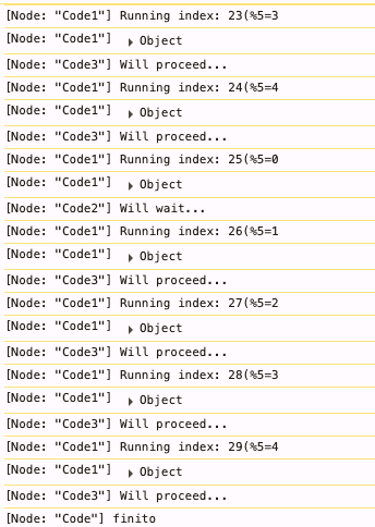

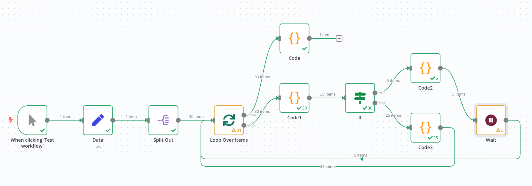

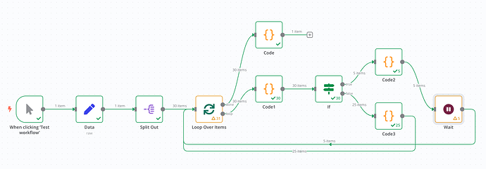

I’ve updated my test workflow and implemented some debugging console.log().
It seems the loop is never completed: it only processed 11 items and never reacher the done step in the Loop Over Items node: any idea about the reason?
:thinking: it completes on my instance
Mmm… do you have a self-hosted instance or a cloud one? Maybe there is some sort of configuration for test workflows? (I’m using a self-hosted instance)
I am also self hosting the community edition
Mah, I don’t know why in the test workflow stopped. Anyway, I implementend the same logic in the real workflow and it works like a charm :muscle:
Many thank you for your great and fast support! :pray:
