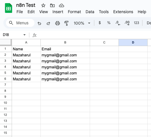

Current I have 2 sheets: Sheet1, Sheet2 and each of them have identical data in each rows.
Sheet1: 5 records
Sheet2: 6 records

Records in google sheet
