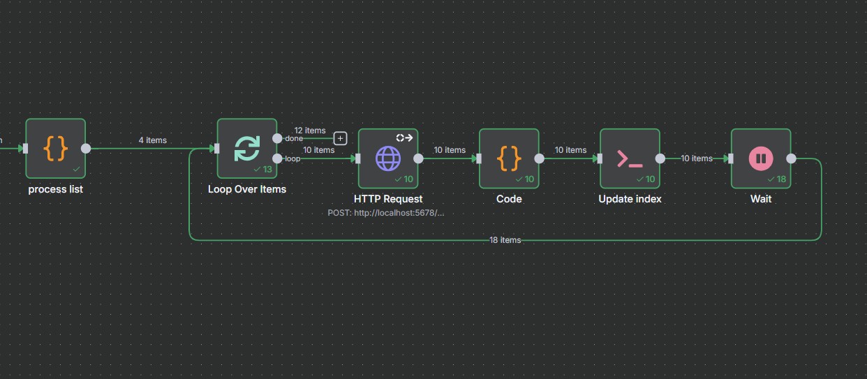

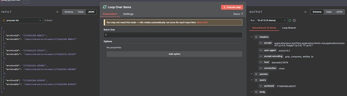

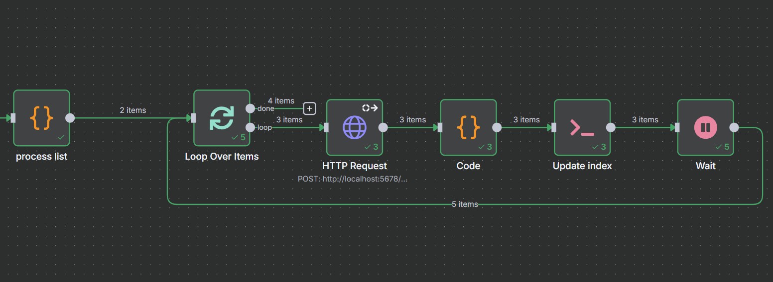

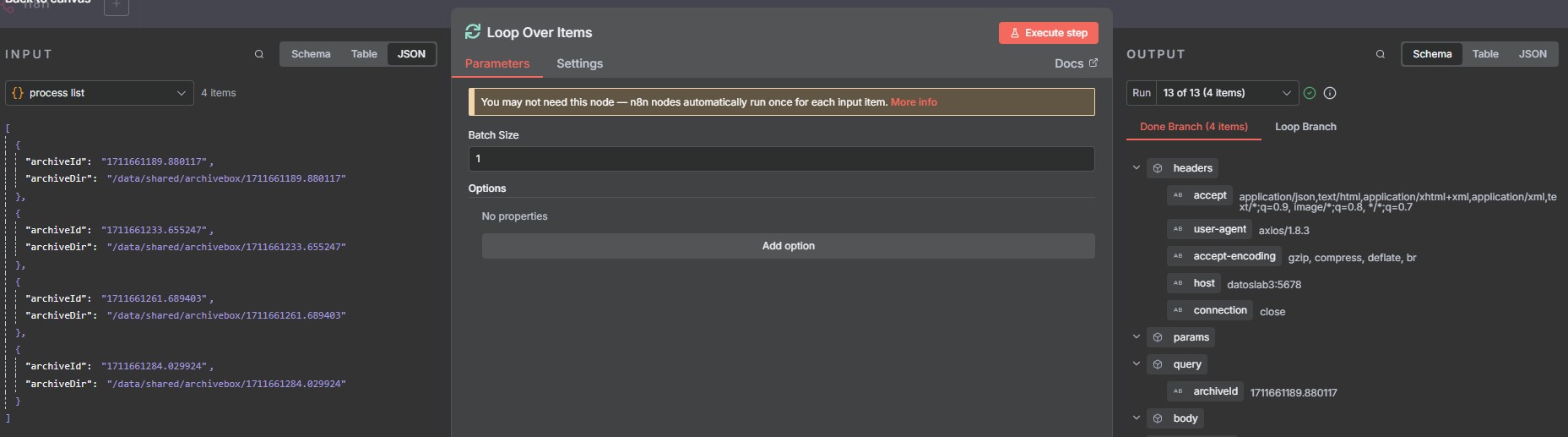

I encountered a strange problem where Loop Over Items node executed more times then input item count. It is a fairly complex set of workflows so it will be difficult to share them here; however, I have taken a few screenshots from 2 different executions when this occurred. The workflows run as follows:
Main Loop (with Wait on Webhook Call) via manual trigger → Init Step via webhook trigger → Process Steps via webhook triggers, when all steps are completed, call the Main Loop’s $execution.resumeUrl.
Screenshots of the Main Loop are shown below and I have checked the workflow executions for the Init Step workflow to confirm duplicate executions were created a few ms apart, ie it’s as if the Main Loop fired duplicate HTTP Requests consecutively.
1st occurrence:
2nd occurrence:

I believe I have found the root cause. In my setup, the 3rd workflow, Process Steps uses a loop to process varying number of steps depending on the input, at the end of the loop, it sends Http Request to the Main Loop’s $execution.resumeUrl. Because I did not use an aggregate node, 1..* Http Requests were sent.
Meanwhile, the $execution.resumeUrl appears to be the same for the entire execution/session, ie the $execution.resumeUrl is the same for all items in the loop. It seems that when the wait node received multiple web hook messages concurrently, it behaves in a nondeterministic way, ie sometimes it advances the loop index, other times it repeats the loop without advancing the loop index causing duplicate executions.
Furthermore, the execution details on the Main Loop drops/omits these misfiring unless the user happens to be running the workflow interactively and “catches it in the act” so to speak. Because I kept my last interactive execution window open and I was passing along the loop item’s PK/ID as query parameter when calling the $execution.resumeUrl, I was able to see that the Main Loop's wait node webhook received duplicate messages for some PK/IDs.
