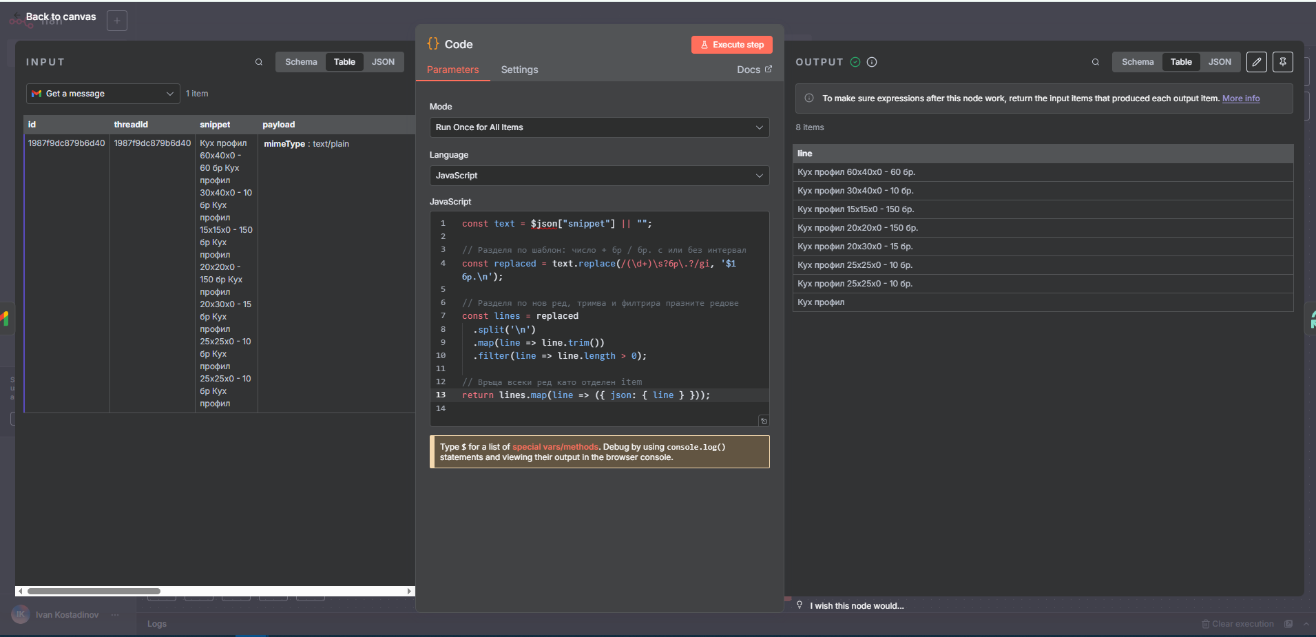

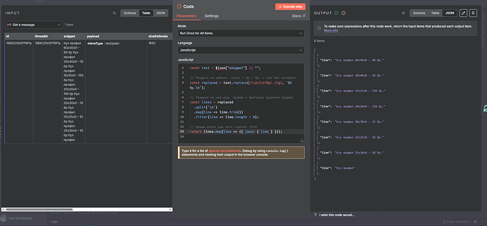

My workflow starts with a Gmail trigger. I receive an email that contains either a PDF or JPEG attachment. I extract text from the attachment, and at the end of the chain, I use a “Code” node to clean and split that text into multiple lines – one line per item (see screenshot).
The code returns an array like this:
json
  { "json": { "line": "Кух профил 60x40x0 – 60 бр." } },
  { "json": { "line": "Кух профил 30x40x0 – 10 бр." } },
Now I want to loop over each of these lines using the “Loop Over Items” node and append them one by one into a Google Sheet using the “Append row” node.
The Problem:
Even though the Code node clearly outputs 8 items, the Loop Over Items node only processes the first one, and then stops. It does not iterate through all 8 items.

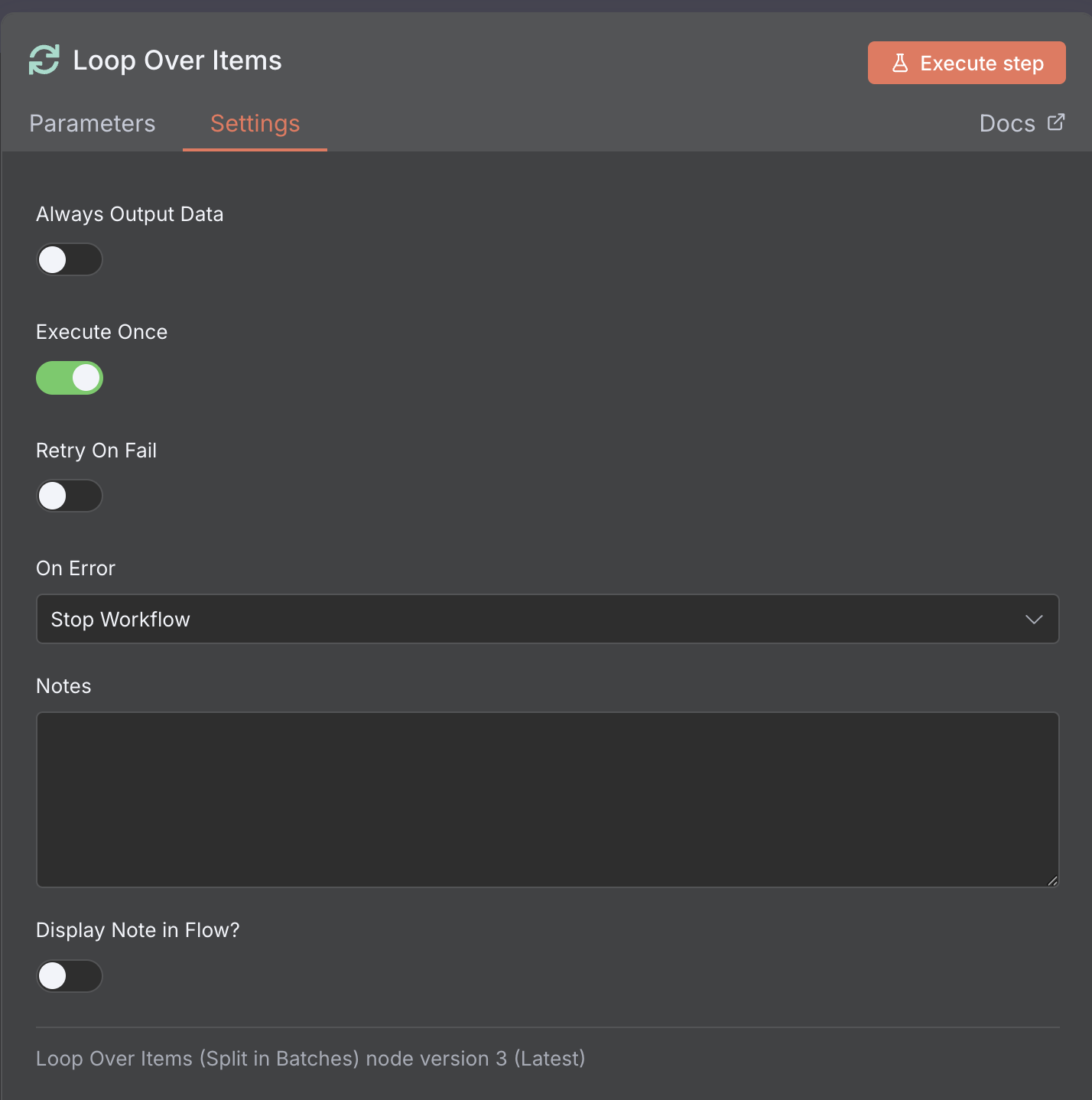

Is there any possible you check the option in the loop node?
Unfortunately, that didn’t work either, but thanks a lot for the suggestion!
