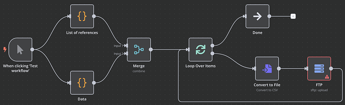

Thanks @ppcm , Though I still do not understand why you need the Merge node in the Loop and not before it. Merge the outputs of Code nodes prior to feeding the data to the Loop node. It just a matter of configuring Merge to your needs. Visually I expect to see something like this

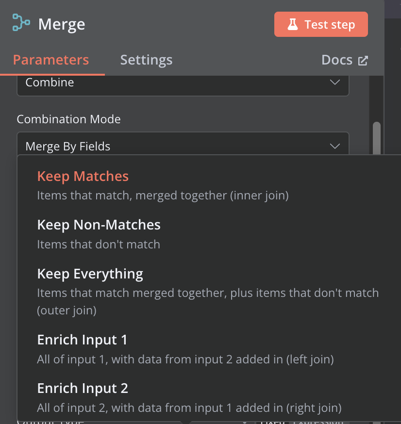

The Merge node has many options. You can configure it to output the reference list enriched with data from “Data” node. To make it clearer, consider the options shown below. I’m not sure what data you need to start looping over them to give you definite answer but I believe that Merge node can provide for your use case.

But now, with your workflow, how to split data to generate one file per reference (generated in node “List of references”)?
