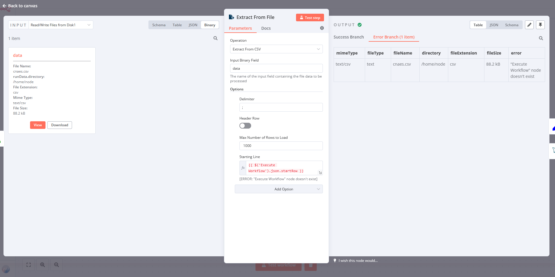

I followed all your steps, it seems like a great idea but I’m having issues with this node.
sub workflow
Hey @miguelraatz,
As mentioned it was never going to just work and was just a rough example for you to fill in the blanks. In this case the error is telling you the node doesn’t exist which is correct as the node is actually called Execute Workflow Trigger, I also missed out the .item part as well so the correct expression would be something like {{ $('Execute Workflow Trigger').item.json.startRow }}.
