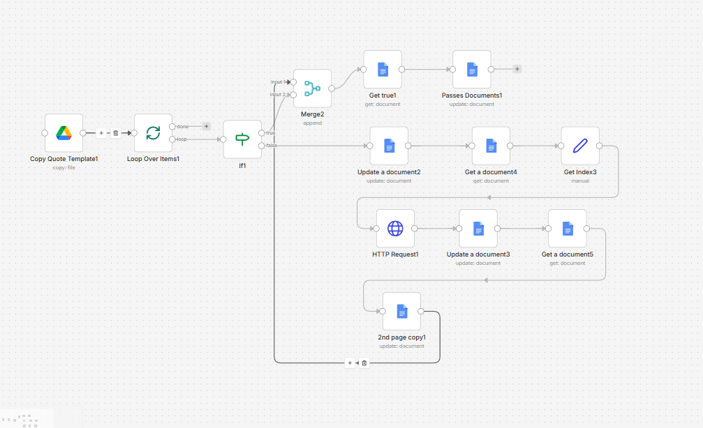

When the loop passes tru the “2nd” or “nth” time i want to use the exact document that the last node uses but everytime i use that ID its just says “The resource you are requesting could not be found” i even tried uploading the file on google drive an copy that and use that copy as a file but coudnt, please help
some context, why i needed the loop. each “loop” has each own unique text and image attached to it. so each loop will be on the 2nd page of the document (already figured out how to do this 2nd page thing but not shown here)

But what I can see from the screenshot:
Your “loop over items” node can’t loop over any item, since you’re not connecting your workflow back to its input. So there is no benefit of using it right now.
Usually, a “loop over items” is not required when you’re processing just one item
Please paste your complete workflow here and explain what your final goal is. Then I’m sure I can help you out

What I think is still missing here is that there are really two different patterns, and the fix depends on which one you want. If each loop iteration should create its own document, then the document ID needs to stay inside that iteration and be passed forward with the current item. But if you are trying to keep updating the same document on the 2nd, 3rd, and later passes, then I wouldn’t rely on “the last node’s ID” at all. I’d store that document ID explicitly on the item right after the copy/create step, and then keep using that same field through the rest of the loop. With a flow that branches and merges like this, item linking can get messy, so carrying something like docId in the item itself is usually much more reliable than reaching back to another node output.

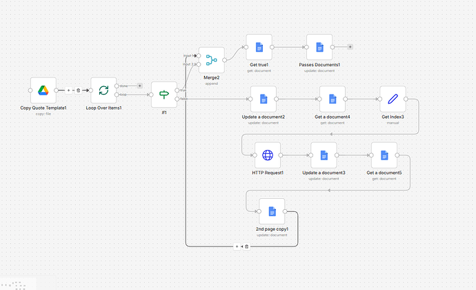

found fix already, i created a Copy document node before merge(almost at the start of the flow) but on a different path so it only copy one document, carried that data to merge and combine, to make that docid for that datas that will come from a different path. so each data will be tied to that one docid, so down the loop the flow will not get confused why there are multiple docid on the loop and im forcing another ID on it since there is already a set program on the loop.
