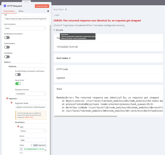

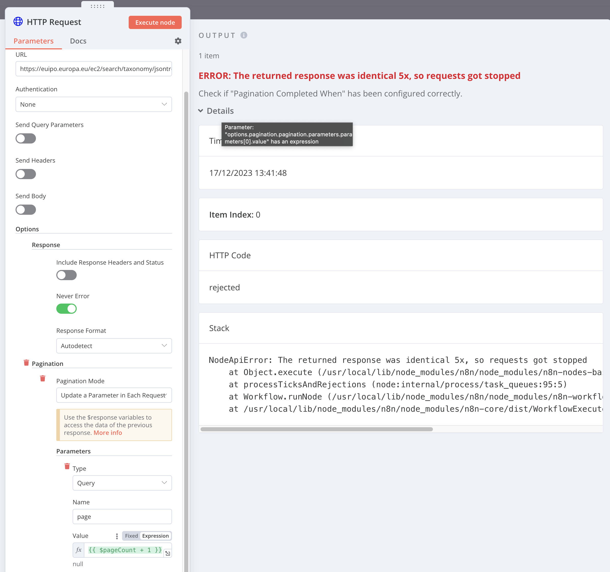

My main question being: N8N knows when it reaches last page (as shown I when it stops the node with an error message), can I use that same capability to stop the node but still return items?
@Joachim_Brindeau , no, n8n cannot know when there are no pages left to query. Your screenshot indicates that the error took place while querying the API, which happen to be due to misconfiguration of the node on your part. The node error-ed to prevent endless loop (I didn’t even know there was such a thing in n8n).
To prevent endless loop the node needs to be reconfigured to utilize the number of pages. This could be done if you know how many total pages are there. The API you use does not tell you that. Therefore, you cannot use the pagination feature in this case. If it worked the old way for you, I would suggest to stick to it while querying this specific API endpoint.

Again, the API you use does not seem to provide any information to figure out when to stop. You can use $pageCount to update URL with each iteration in your example. However, n8n will not know when to stop unless your API returns something to indicate “this is the end”. Perhaps it retuns an empty array (I’ve no idea). If that is the case, then yes, you can leverage that and use in the node’s condition when it has to stop.

It does make sense and as the error suggested n8n did detect that the same data was returned - “The returned response was identical 5x, so requests got stopped”. Therefore, I would encourage you to create a “Feature Request” (as opposed to “Question”) so that n8n team could consider such an option.
