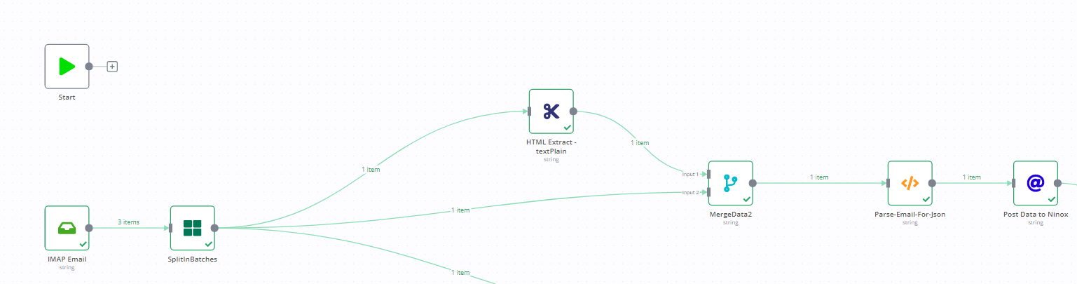

I’m listening a mail box, when I have multiple from IMAP Mail Node, It multiplies on Merge Nodes,
So I want to send all mails that I receive from IMAP Mail one by one and finish the flow one by one.
  • Like above picture,

I tried but it didn’t worked as expected,
I have 3 mails in mailbox and I receive them,
But only 1 of them saved when I use Split in Batches Node, (I could see the database records, there were only 1 new record.)
It works like getting only the first of them.
My split in batches node;
Where do I do wrong?
At the end you need to put a line back into the splitinbatches node. Otherwise It will never start on the next. :slight_smile:
