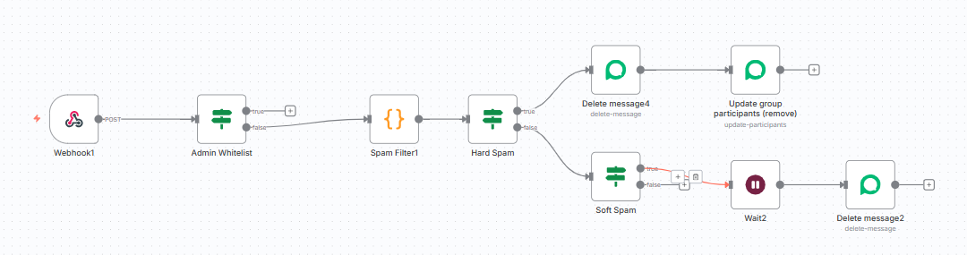

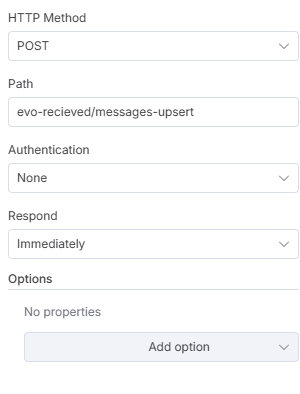

I’m using n8n to handle a webhook that receives messages from the Evolution API with follow-up moderation actions (I run a huge WA community and got sick of all the spam and promo accounts).
I’m facing an issue where the webhook is re-triggered not only for the initial message but any additional requests related to the message status updates I suspect it’s generating when executed. In short, the moment delete_message, update_group participant, etc. get triggered, their node begins to loop in production. It makes my workflow absolutely unusable, sending hundreds of requests every second, even though in testing, it works perfectly fine.
In short:

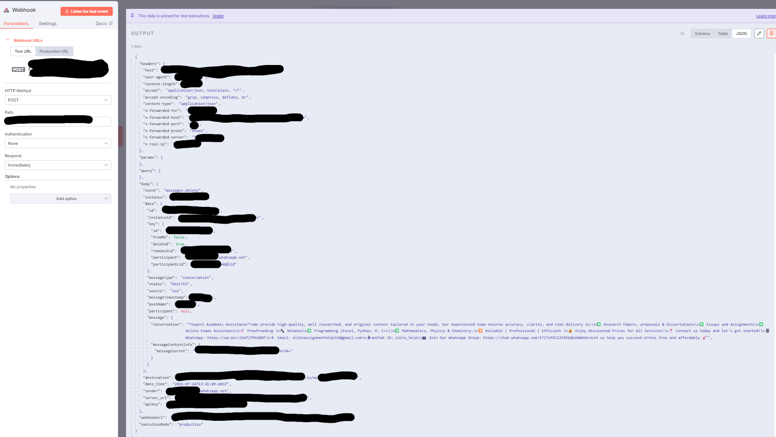

- Webhook receives metadata from message_upsert

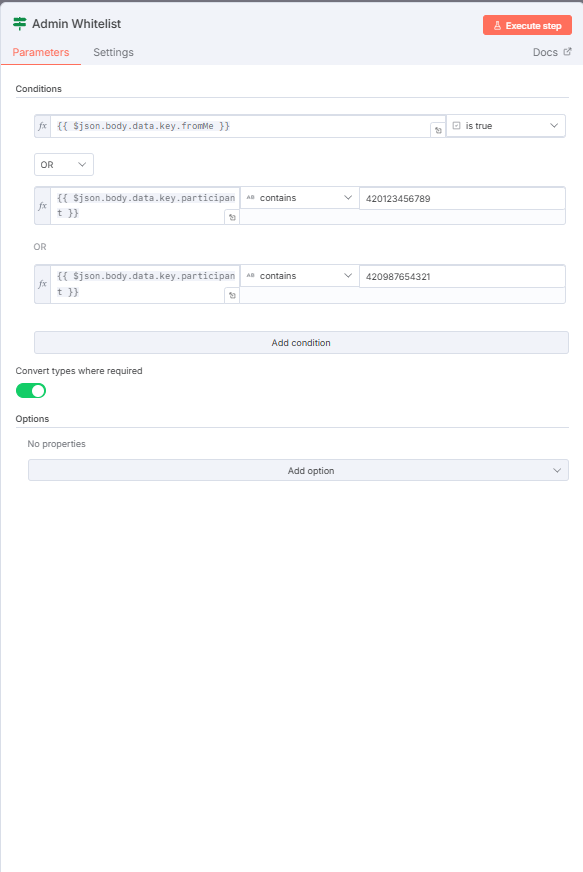

- Message passes through admin check (to ignore pre-defined numbers)

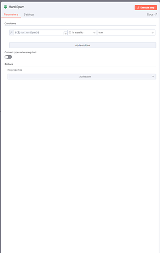

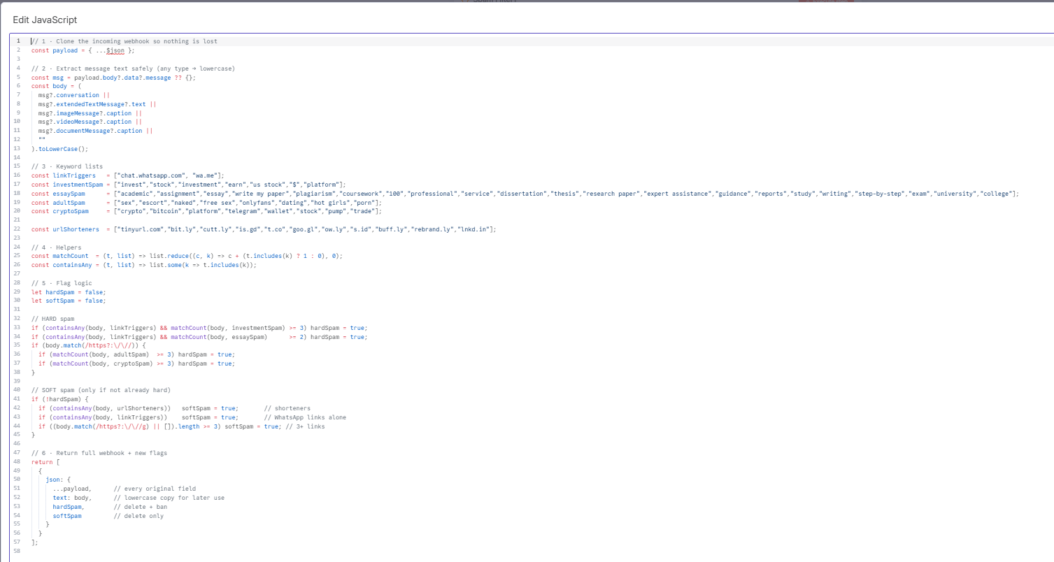

- Spam filter defines hard spam {{$json.hardSpam}} and soft spam {{$json.softSpam}} which is later filtered through the IF nodes.

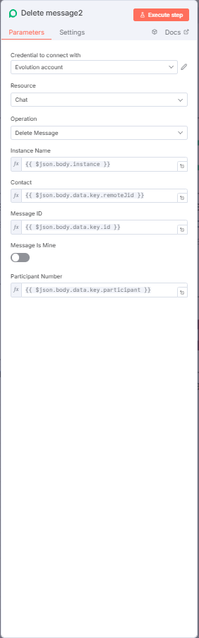

- Hard spam follows the “Delete message + Remove participant” route;
Soft spam follows the “Delete message” route - Now workflow should end (I am planning more features after I fix this)
Any idea how to stop the loop? It keeps looping and sending API requests until WhatsApp bans the number (learned the hard way). I just need it to execute once, or learn how to control the loop. So far I coudn’t find the answer anywhere and AI is not helping either.
